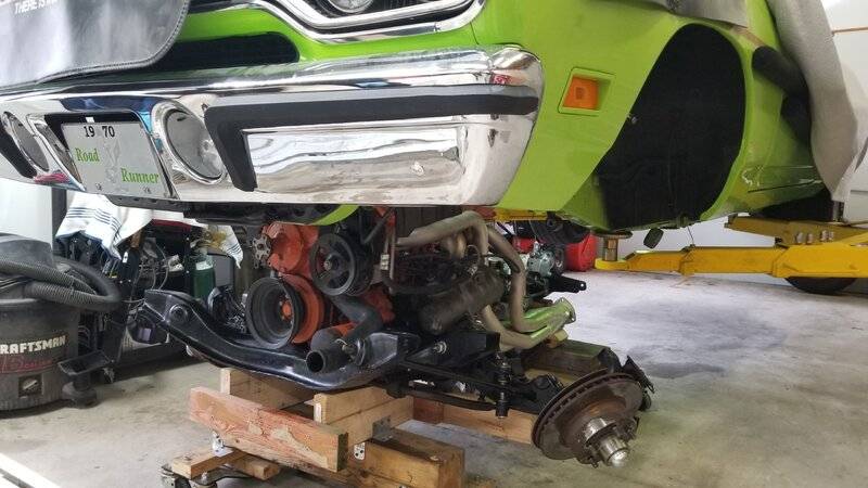

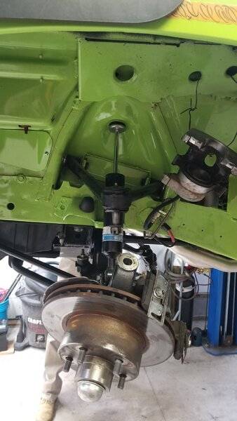

Having that lift must surely make the decision to pull the motor a lot easier. No need to go crawling around on your back anyway. :thumbsup:
You bet. Having the lift makes dropping the K member actually quite easy, and very controlled. It's really the only way I'll do it any more!

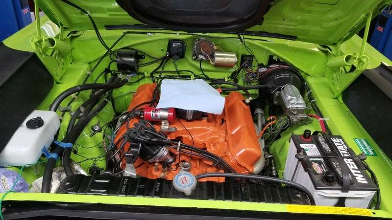

A bit of progress on the 70 engine swap.

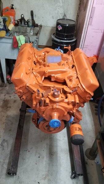

I got my old 383 a little cleaned up. Mind you, I did VERY LITTLE to it since it will only be back in the car temporarily (while I go through the 500 stroker engine to check it out). Heck most of the old grease and grime are still on the old 383 - I had just a little bit of paint left in a can so I spritzed the top a little bit until the paint ran out! But it is serviceable (thanks to @Don Frelier for a replacement rocker arm). It is still together as built from the factory with about 80,000 miles. It is getting a little bit tired, some of the valves are starting to leak, but it runs well and reliably. So back in it will go for awhile!

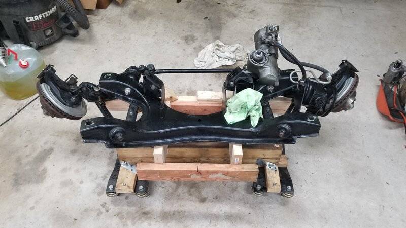

I wiped down my K member a little. Again, nothing serious here since I will do a mini restoration of it later when the stroker goes back in.

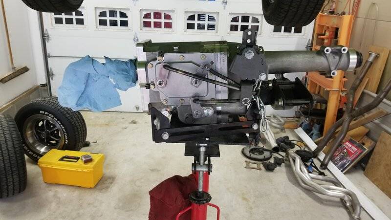

My Passon A-855 5 speed is now just needing it's fluid replaced after the 500 mile break-in. So best to do that now while it is easy to get to!

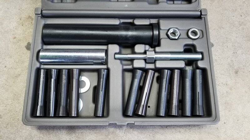

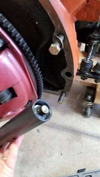

First I had to remove the stock dowel pins in my car. I didn't have a dowel pin puller, so I decided it was time to buy one. This is the kit I bought:

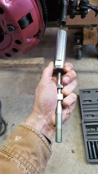

It works nicely. You put the right sized collet on the pin, then slide a barrel over the collet and screw a double threaded bolt into it. Below is an view of how they go together:

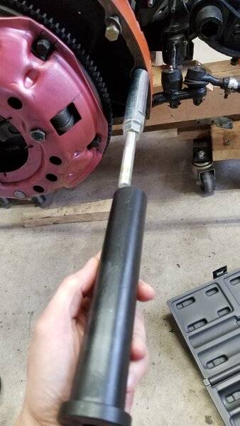

Then you tighten the double threaded bolt which draws it tight on the dowel. Finally, slip the big black barrel piece on it and tighten the final nut. This draws the whole assembly out in a nice, slow, controlled manner.

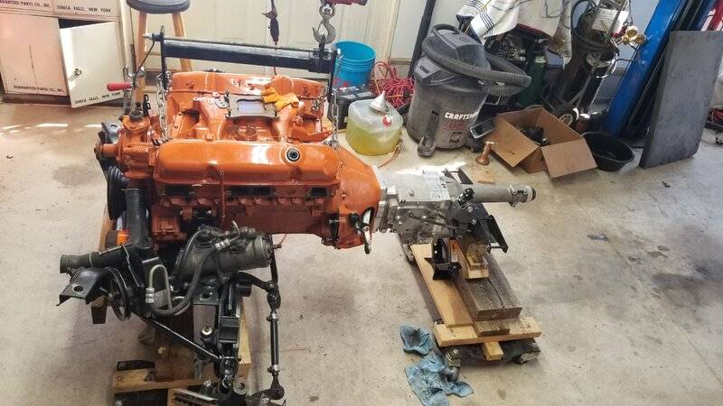

Finally, it was time to mount the transmission. With my 23 spline transmissions, I have always pretty easily "thrown" them in pretty easily, but this 18 spline A-855 has always been more stubborn. It seems I work at for a while before it finally slips into place. At any rate, finally it did, so now I can start mounting starter, headers, and other final parts before I reunite this with the car.

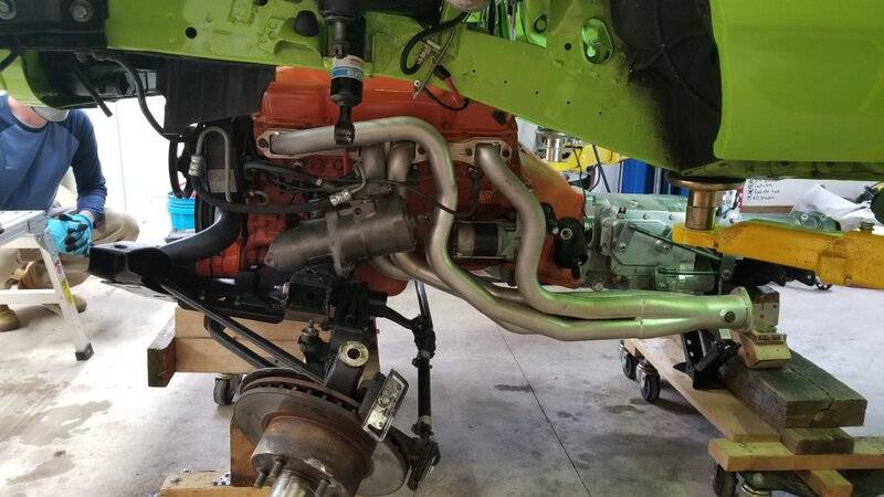

This morning a couple of friends and I installed the engine/ transmission and K-member.
Pretty basic stuff at this point, as I have done this several times. As has been discussed on FBBO many times, everyone has their favorite way of installing engines, but mine is certainly from the bottom: nice, slow and controlled. Plus you can assemble starter, headers and many accessories on the engine before you do - much easier!
Here is the car as it was getting close to the engine assembly.
It went in smoothly and without any issues; we attached the K-member and transmission crossmember bolts.
Once K-member bolts and transmission crossmember bolts were attached, then we connected suspension and brakes.

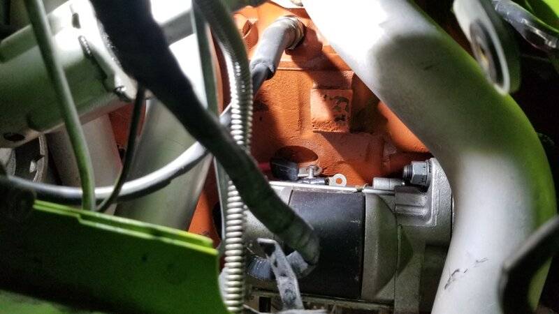

One of the things I hate to work on is connecting the starter. There is simply no room to do this, and you have to work without thumbs because of the limited access. It is simply a pain in the butt to get two simple wires attached and bolted to the starter!!!
After a few cuss words, I finally got it attached. I still need to connect up steering, wires, fan etc., but there is not too much left before the car is (hopefully) mobile again!
