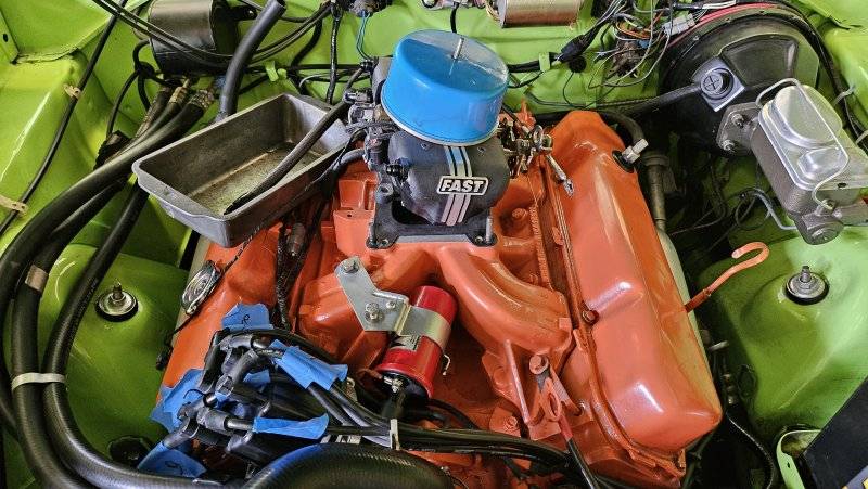

On another note: I continue to have issues with my Road Runner. Quite frankly, I am concerned now. I went through the ignition system expecting (hoping) plugs and distributor cleanup would address the issues. It did not. After some discussion with F.A.S.T. support, the injectors could be problematic. Pulling them is not particularly easy and I don't know how fast I can get a new set. But I am working diligently on them...
I hope to get this issue resolved and will bust my arse to get the car fixed. If I cannot, then my backup plan is to drive my beater daily driver Corvette (and I have no doubt I will take a lot of crap for driving a Chebby...). NOT what I want to do, but the best I can do if I can't get the Road Runner fixed in time.
I understand. Sometimes things don't come together as fast we hope.looking less likely for me, sorry
Hopefully I can source them quickly enough, get them in, and that they are indeed the issue.In this case, it is stupid. Me! Even if this does not turn out to be the issue, not running a fuel filter with fuel injection is a really bad idea. Not sure how I missed putting the filter back in, but it is what it is....hopefully, that solves your problem......more often than not, it's something stupid and/or simple

Well mine both run perfectly.Update: I have the injectors on order - they should arrive on May 23rd.
So @Don Frelier promised me that this was the issues, so if not, I get to borrow one of his cars!!!
Anyway, I got them on.Correct. Actual AFR value doesn't change at all.Afr reading doesn't change at all?
On the MSD it reads 35 when you power up and don't have the engine running.
Did you try raising the setpoint to like 15 or higher and watch the duty cycle on the injectors?
From what I understand, the O2 sensor is a Bosch LSU4 type, reading wide band air/fuel ratios from 9:1 to 16:1. It's designed for closed-loop applications. So yes, there are differences in O2 sensors, and I think I have the correct replacements, but they are not FAST branded.@HawkRod
Could there be a difference
in O2 censors, between Closed & Open loop systems ?
just spit-balling, or does a O2 sensor in the F.A.S.T. EFI not care
location of the censors, not on the bottom of the pipe
needs to be up the side or on top, so excessive moisture doesn't kill it
good luck
