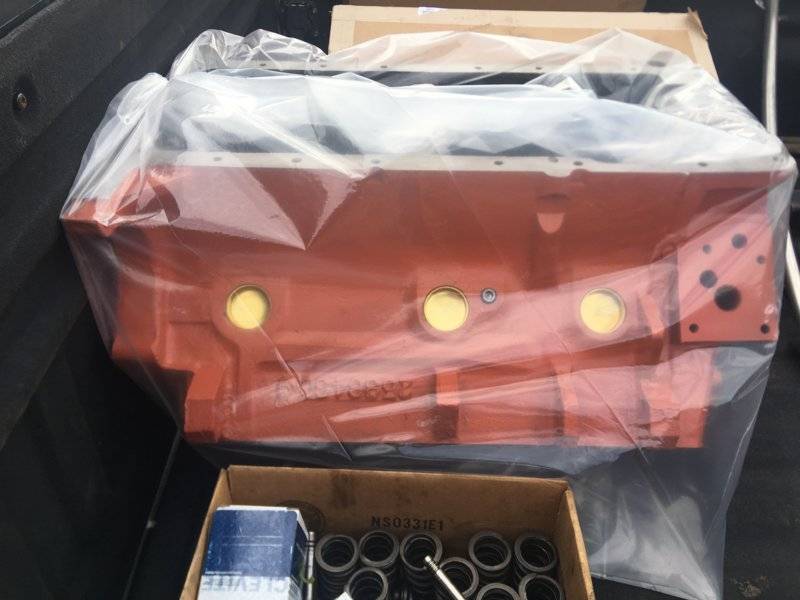

Just picked up my stuff from machine shop for my 512 Stroker/Six Barrel build. I purchased kit and stealth heads from 440 Source. My question is the kit + heads calculates to 10:5 compression using a .039 compressed head gasket. Using Cometic gaskets and thinking of going .051 thickness. Does anyone see this as a problem?? Also is 4.380 correct for .030 bore??

On the bore, no. Stock 440 bore = 4.320", so it sounds like your block is .060" oversized, not .030" oversize bore.

The Std. bore on a 440 is 4.320". So +.030 is 4.350 . What is the deck height on the machined block?

Depends on what block you start with. You can build a 512 with a 400 block bored .035 over, or a 440 block bored .060 over with 4.25 stroke crank. That comes to 4.380. So if you are building with a 440 block, .060 OS pistons will work. Need to know what pistons you have yo calculate C Ratio. Are they the flat top with a dish ?
Standard deck height was decked enough to clean surface. The put some specs on paperwork, so I will have to look.

I think OP was asking if the 4.380 gasket is good for a .030-over block...yes. You don't want it hanging over anywhere, the often used tried-and-true Felpro 8519 carries a 4.4" diameter if I remember correctly...
The light just went on!!!! I think 4.380 should clear the chamber and bore. The Felpro 1009 which I've used is 4.410. Thanks Beanhead!
