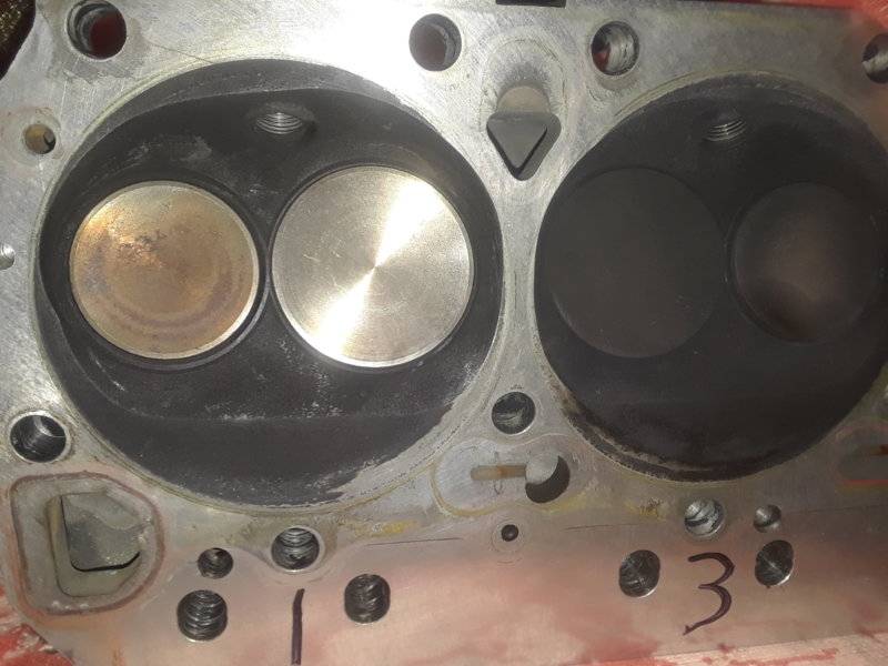

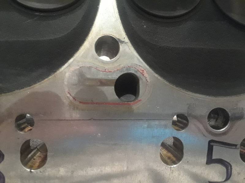

When I pulled my 496 apart, it had copper head gaskets on there. And no O Rings. It did look like there is some red RTV like substance on there.
Every copper gasket I looked at requires O rings. So not sure whats going on there. Also wondering why copper works with Aluminum heads, while steel shim is not recommended. Cast iron, copper and aluminum all expand at different rates. But these heads were sealing fine, no evidence of leakage. I have used steel shim gaskets with aluminum heads before, and they sealed fine. Has anyone else had good luck using the steel shim type with aluminum heads? Thanks. Oh, these are the Stealth heads.

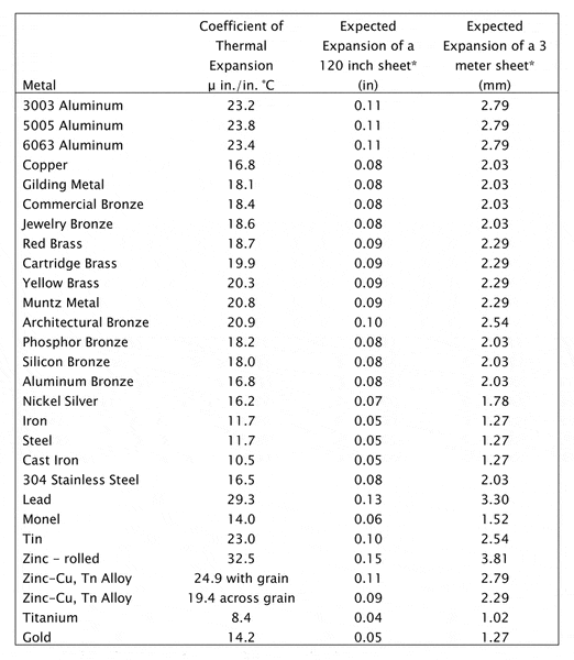

Hmmm..... maybe somebody here knows more than I do on this (likely), but I don't see any obvious "thermal expansion" or "corrosion" issue related to using a steel shim gasket vs. a copper shim gasket.
"Maybe" the copper gaskets seal better because copper is more malleable (softer) so it can squeeze into head/block surface defects to make the seal better?
I think the issue is, the different expansion rates between cast iron and aluminum. This stresses the gasket, I guess, causing it to eventually fail. The car manufacturers have had problems with that since they started using aluminum heads on everything. So they came up with the MLS gasket, which has several layers. Then these can slide across each other, without failing. Using the steel shim is a bit of a risk, although lots of guys have had success with them. Fewer miles, and mainly warm weather driving helps, I'm sure. I have had no problems with the 1 motor I used them on.
Cometic has perfected the mls gasket system. If your going to use copper you will get long life. The picture looks like they sprayed the copper with Hi tack made by permatex. Have no fear using copper.
