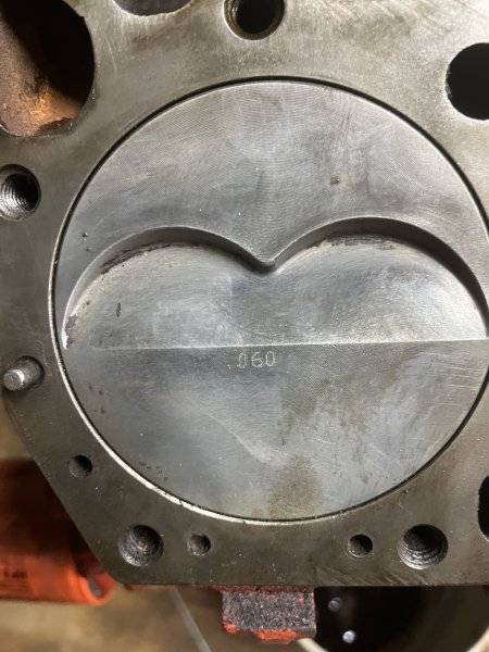

Its a 440 .060 over, forged crank, LY rods with ARP bolts I'm not sure what the pistons are just yet as I was collecting parts before I start to fully take apart the rotating assembly. I will go take some pictures of the piston at TDC I don't have a good way to measure piston height other than feeler gauges and a straight edge. lol

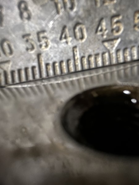

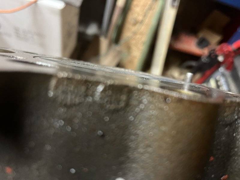

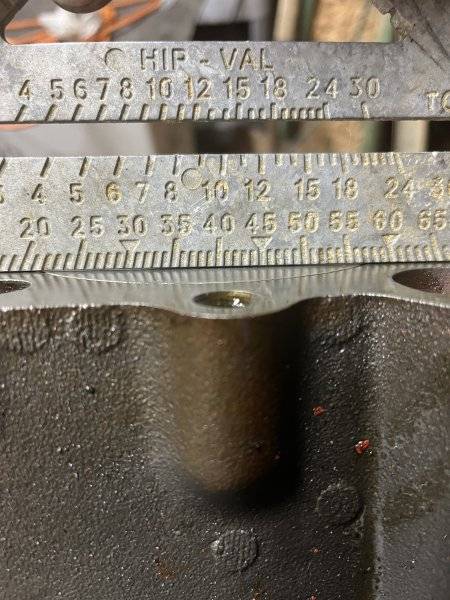

I just went out and half assed some pictures of the piston height. I used a speed square across the piston. If I had to make a guess Id say around 5 or so below deck height.
