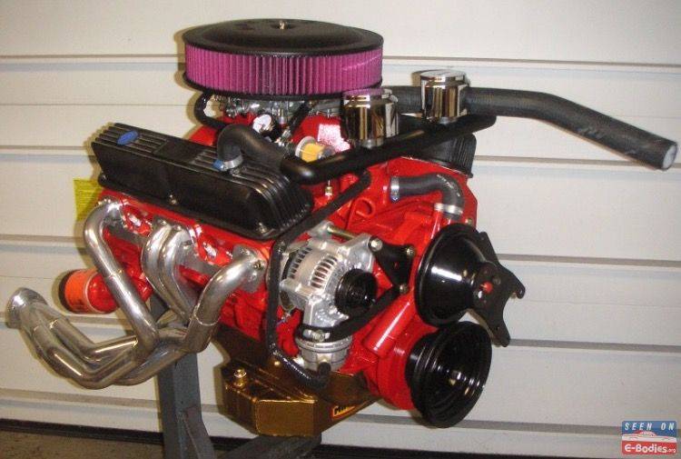

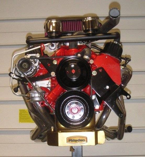

My Sixpack is on a small stroker, my whole system is stock. Never have had a vapor lock problem. You might start looking there, do not remember having vapor lock problems way back when. Except in very high heat and humidity, sitting in the staging lanes at the drag strip.
