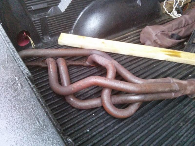

This is the driver side that was taken off. Giant spaghetti monster, cant tell what kind it is.
