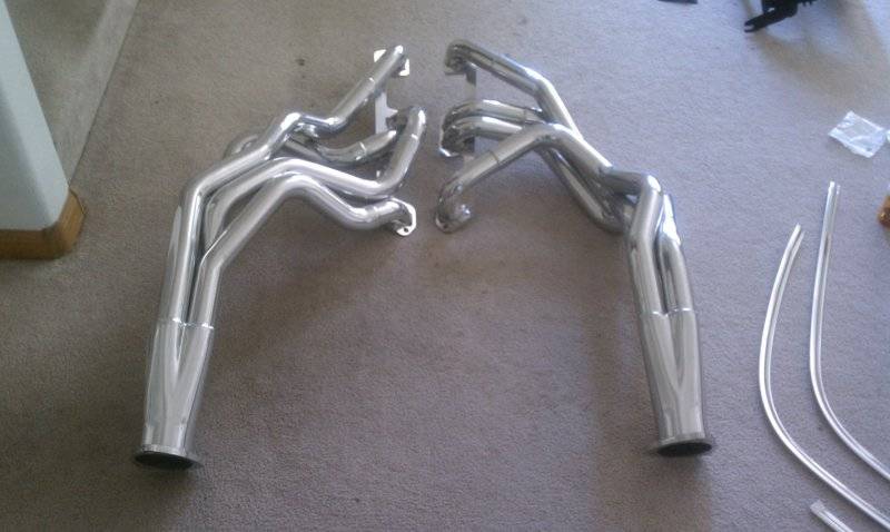

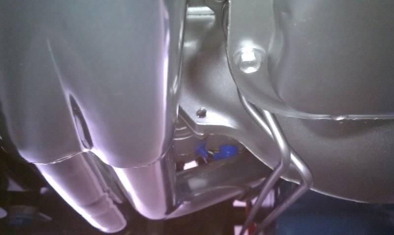

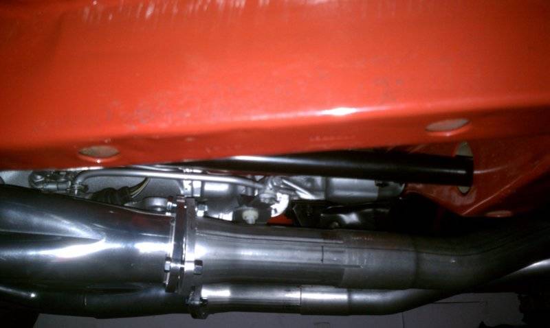

Here are the ones I used on my 340 RR and a couple of underside shots!
