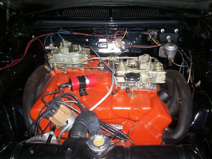

on my 500 i did M/W repops looked cool but the weight and heat was unbearable should have gotten hedders they were cheaper
Thanks for your reply.... I was wondering about the extra heat. I do have a couple questions.... how did you get Holley carbs to work? I tried but I couldn't get the linkage set up correctly. And with a name like moparsquid you must have spent time in the Navy....
your observation is spot on , I retired in 95 with just over 20 years. as for the linkage i actually purchased these from e bay the linkage was not stock but looks like some one made their own rods but the center pivot was max wedge had to trim some of the carb linkage to clear the manifold once i got the kickdown and throttle cable set up it actually worked very well
I retired in 08 after almost 33 yrs as a Master Chief.... did you run any carbs other than Holleys? If you get a chance could you take a few pictures of the linkage.
