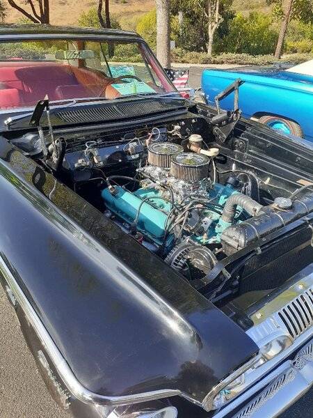

sorry i never ran any other carbs i didnt take that many pics (im bad at that) and ive changed my set up to a dual 4 set up my advice is to cobble up something using the little carb pivot pins that are round on one end and screwed in on the other side you might have to go to a parts store or a junk yard if i find i took better pics ill send them also you might look at hemi cross ram linkage to see if it could work

mine dynoed at 558hp 571tq at the wheels.
"at the wheels", so appx 10% loss thru the drive train makes it 600+ HP motor..pretty std from what i understand with the crossram cork in the setup, same as mine, i have read where some guys have used heads that flow around 350 and a solid roller with over 260 @ 50 and dynoed 650 HP with a crossram.. which in a few weeks that will be my combo with TF 270's...we have the same carbs, AVS 2 650's. did u have to change them much to get them to work ? jetting, springs, and shooters. i hear #43 shooters makes for like F.I. response..
