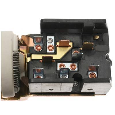

The rheostat wheel ( ceramic wheel ) gets a track and a point with the spring ( rheostat itself ) in the middle of the circuit. Have you checked the track and point and making contact with the spring assembly? Replacement parts are latelly POS.
And also wondering. Have you spining the headlight switch knob to try on several positions of the dimmer? This could sound basic but some ppl may not know the dimmer works rotating the headlight knob!
This is a X car headlight switch. Doesn't matter, but all work the same, just can look a bit different
The yellowish strip takes to the central tracks between switch assembly and ceramic wheel. That should be the ouput from switch to feed rheostat
The redish strip takes to the point which will take the power after the rheostat ( spring ) and the rheostat position againts this point will vary the voltage going to dash lights.
This point must be making good contact with rheostat. It also gets a position where doesn't make contact with rheostat to turn off dash lights.
Central tracks must be also making good contact between them. On this pic there is a gap visible. It shouldn't exist any gap. Usually once the knob is in place the wheel keeps centered and saves all the gaps. Here it looks some twisted.
Somewhere around the wheel, there is also a tab which is simply pushed by a molded lever on ceramic, just to send ground to dome light. But that's a diff deal. ( I think is visible on a darker area on bottom part of the pic at wheel )
NOTE: I used this pic because is the only one I could find to show the dimmer assembly function. I think on your switch you won't find the yellowish stripe to feed the central track, because as far I recall on our 3rd gen switch this runs internally from parking lights circuitry ( mostly sure the is same than this pic but here is being taken externally )
