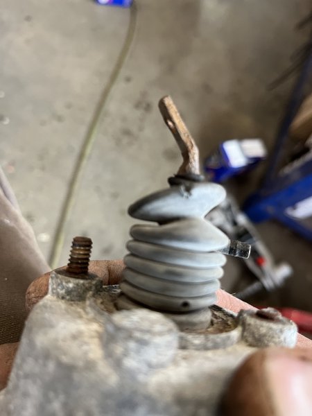

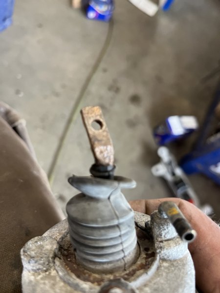

I am restoring the front grille on my 69 charger, and I have been testing my headlight door vacuum actuators with a vacuum pump. My drivers side actuator is not working. Is it possible to rebuild these things?
Also, my passenger side actuator has a bend in the end of the arm, while my drivers side one is straight. The bend looks factory and not an accident.
Is the end of one of the actuators supposed to have a bend where it connects to the headlight door rod? IMG_4452.jpegIMG_4451.jpeg
I have only worked on these when I restored my Superbird, but neither had a bend in the actuator rod.

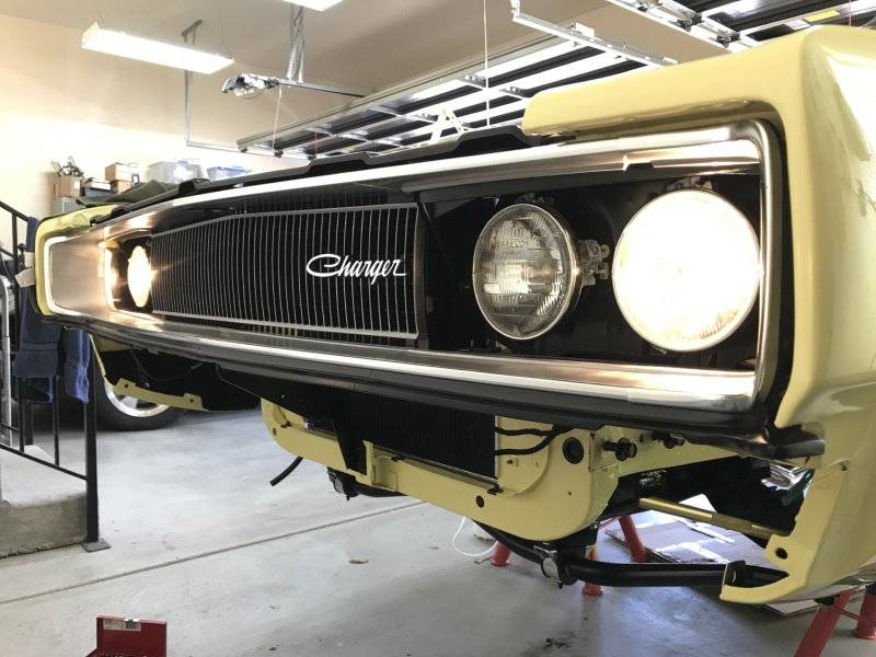

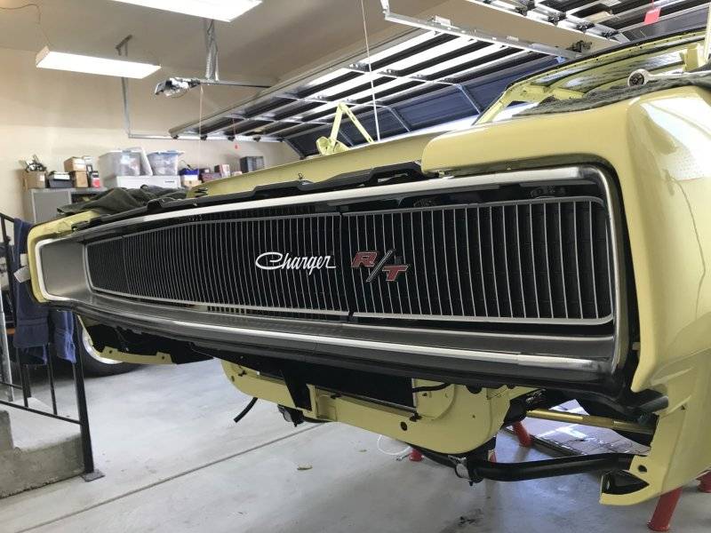

I don't know who if anyone can rebuild the vacuum actuators but I can tell you that your right side actuator should not be bent. I took a couple pics of a complete 69 Charger grille I have and both are straight. Maybe Bambi got too close to yours. Here are a couple pics of mine
