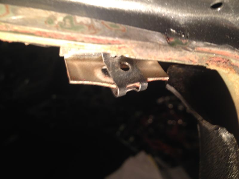

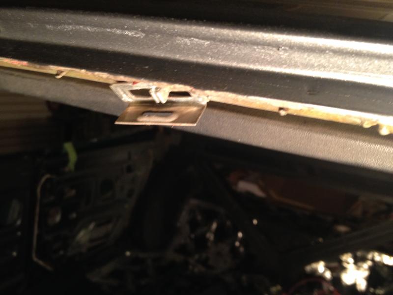

Can someone assist me in how these work (68 RR)? Is this what the headliner trim panel screws into or does the actual headliner fit into these somehow? Only one has a threaded clip attached to it but not sure it belongs (see first pic)? I tried to figure it out from my service manual but the pictures in there do not help much.

Those clips go on after the headliner is installed and only serve to attach the top inner window molding to.
That threaded clip does not belong on there that clip has the screw hole stretched that is why someone put a threaded clip on it

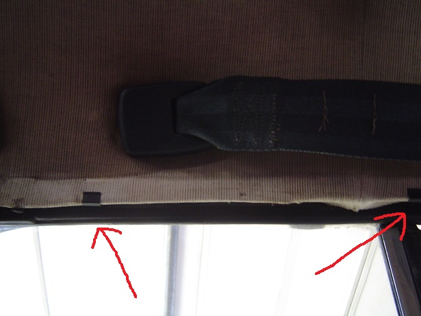

Here is what the headliner clips look like on 73/74 RR satellite there are 3 on each side. Not sure if its similar for 68 or not, but thought I would show example anyway.
Here is a picture that show 2 of the 3 clips, the other goes above the door glass middle. Year One Part number FD26450S for package of 6.
Thanks but I do have the side clips....these are on the front. Thanks everyone for your help.
I'd say the more the better but if 3 per side is good.....
