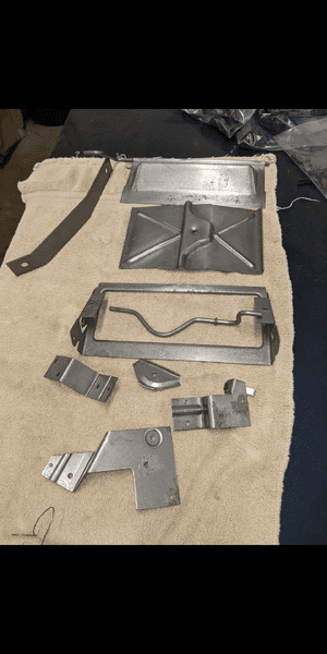

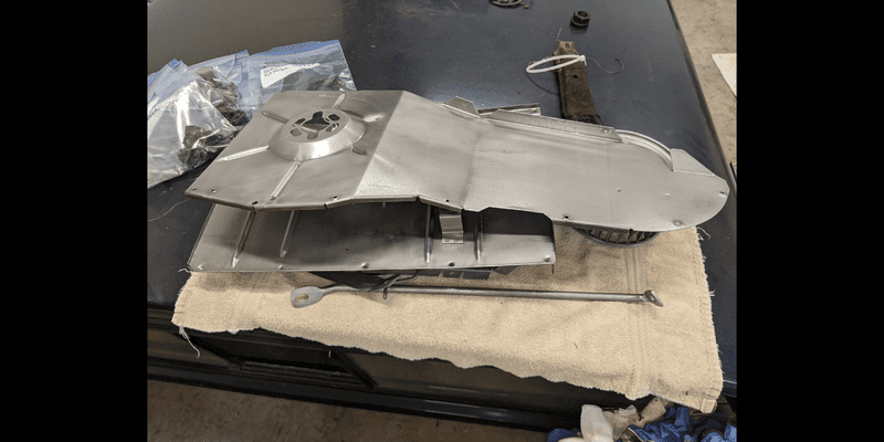

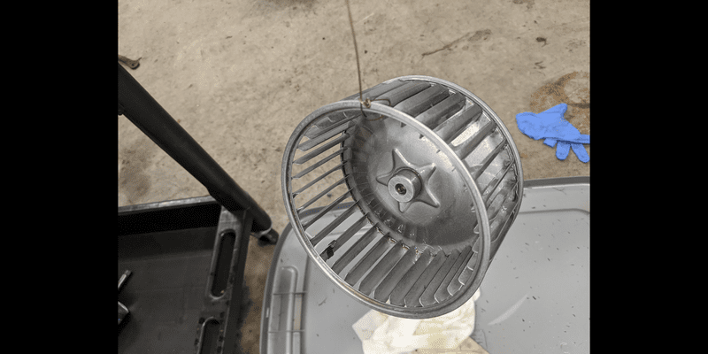

Thanks twist, the metal I just used evaporust. I was lucky to have all just surface rust nothing too bad. As for paint I used Seymour stainless spray paint. The paint will last for ever, just get it painted quick and don’t handle the blasted pieces with bare hands you get rust on it.
