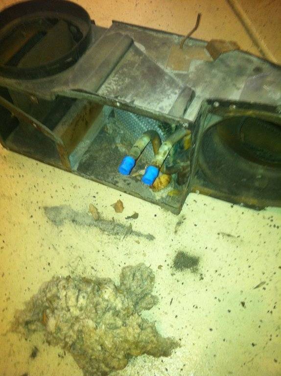

Here's the core from behind, not sure you can pull it out front the front. maybe if you twist it and turn it a certain way it might get snaked out the front.

I'll have to take off the cover and look. It doesn't appear to have any brackets that hold down the inlet/outlet to the core. I have some rubber plugs to plug up the core. So if I twist and turn I won't have to worry about coolant pouring out.
You can't remove the heater core from the front cover the back of the box has a cover that has to be removed to access the heater core. I won't say it cant be done but I think complete removal of the heater box is in order.
I meant the panel that faces the seats. I don't think there is a panel on the side that faces the firewall. I could be wrong.

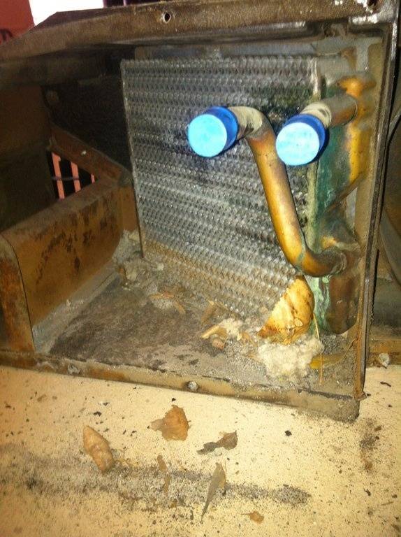

yes, there is a back panel, the entire heater box is enclosed. Here's a picture of the bulk head side of the box with back panel removed.

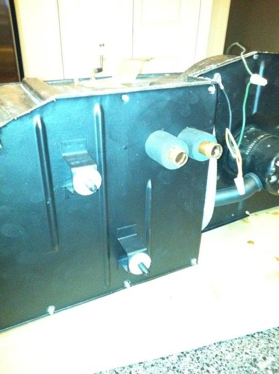

And here's a picture of the back of the heater box with the cover on. Note the foam gaskets that will mount up the bulkhead once installed.
