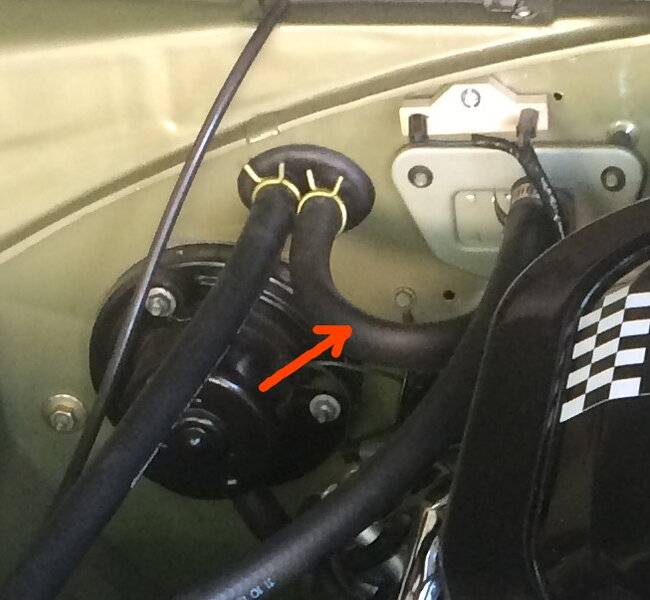

How do you prevent the small hose from kinking? Install a spring or is there a molded hose for this?
Tried something similar, didnt work. Need something close to 6" across.
Check out hose supplier catalogs for molded hose. I know the Dakota P/U used hoses with 90* molded in on one end so, others must be available.
Mike
There is a repop hose on the market for the b bodies with ac.. look at Mancini, year one etc.
Gates 18777 might work for you. Just google heater hose 180 degree 5/8 molded.
That was one I picked out, there were others. Mike 493 is right about suppliers. Silicone will last a long time.
