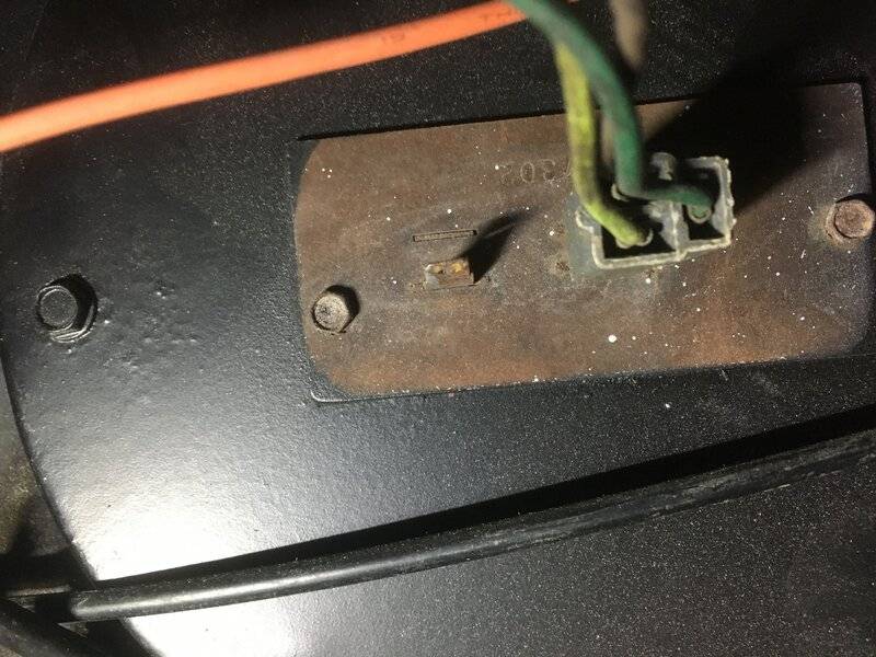

Sorting out the last of my electrical issues ,my car is a 70 Roadrunner no air it was a basket case ,anyway single wire from backside goes up to switch ,3wire plug onto front side from switch ,what wire goes to Lh side of 3 wire plug I took a picture thanks it’s not on my moparts diegeam I printed of line
I can look tomorrow if no one replies
Thanks I think the single wire from backside of heater box goes over the top of box to power fan ,I had that wire going up to switch thanks for looking
on 71 diagram with heater, diagram shows same 3 way plug and a lonely prong away from this group and is labeled as the output to the blower
It should be a dark green wire and I believe that gos to the heater blower switch
Thanks I got it sorted out tonight fan blower works on one speed that’s a start ,I didn’t have the switch powered with the black wire from the harness thanks for the help
