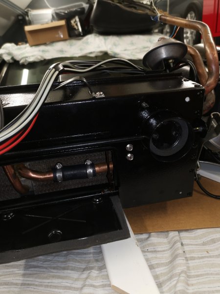

On both sides of the defroster actuator the connections are blinded. Is this correct? I would assume they should be open so the valve can "breathe"
When I complete an A/C box resto I have a small electric vacuum pump (or you can use any source of constant vacuum) that I use to hook up the switches and actuate all the doors and make my adjustments according to the FSM
