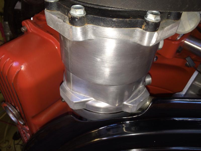

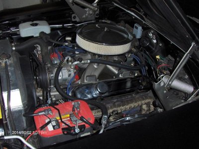

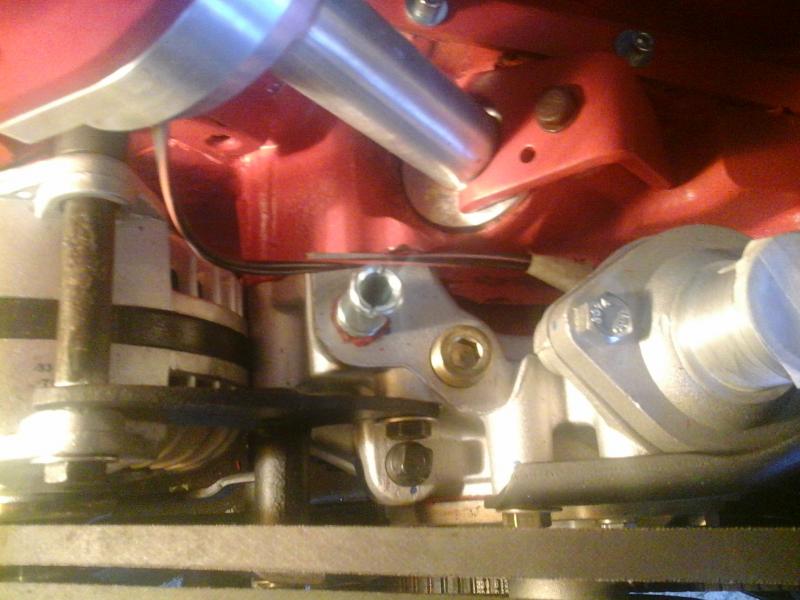

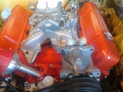

If it ain't one thing it a nother,, I have 1970 gtx 440 , what im having trouble with now is the heating and a/c hoses I changed the water pump , along with alot of stuff uder hood now im running hoses belt and wires,(1)heater hose is to close to alternater bracket and bolt, I got a straight 5/8 s hose to threaded fitting , heck dont even room to get it started (2) I have aftermarket a/c compressor the hoses tie-in on the top, this makes the hoses stick up to high,, can I rotate the compressor so that the hoses tie in the side ,, hope im making myself clear becouse it dont feel like iam,,,
Heres the compressor

when i did my upgrade kit on my 69rr my heater hose nipple fit just fine but that could be since my nipple was for a 1/2" hose & if i remember correctly my bolt head wasnt a thick as yours.
you can also clock your ac compressor fittings to 9:00 or the pass fender as i had to do the same to clear the air grabber base & depending on what you got for hoses & charge ports you might have to get them remade at different angles to clear your distributer
Chooch thanks , that helps , now I know I can turn compressor, , I was thinkin they mite make some fitting that was long anuff to clear bracket?also I have a after maket radiator thats about 3 in larger , in short my radiator hose is to short,,,, it had one of the wrinkle hoses on it worked fine I guess , just dont look as good as a formed one,,,,

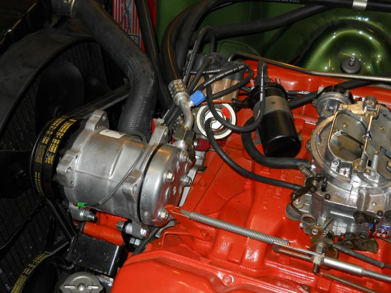

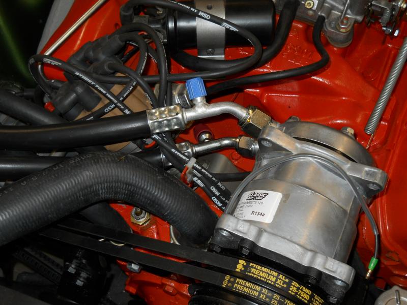

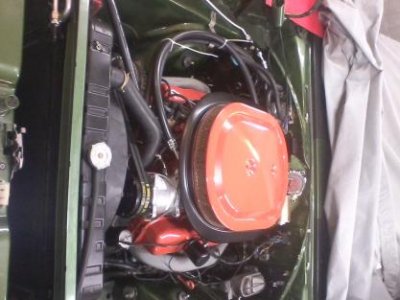

mine has different alt brackets & my heater is not hooked up yet but this is how my ac hoses are.
for what its worth my car is a original ac car so when i did the upgrade kit it eliminated all hoses that came from the drivers side inner fender & just has the pass side hard line & hoses from the compressor but i'm pretty sure the retrofit kit non factory ac cars have lines that go behind the battery & across. heres a crappy photo of while i was trying to figure everything out a few months ago.
btw if your car is a factory ac car you will need to use a 1/2" hose from your wp to the hcv.

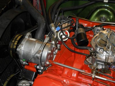

Thanks for pictures big help,, chooch my car came with air ,but my line come from firwall passenger side,, looks like you have same set up as mine, my air grabber is suppose to be here today,, man I hope it fits, you've gave me some hope with picture I know now I can clear ac lines,,, now justhope hood will close, becouse Iv added a mopar wedge intake,,,
my lines come from the pass side also,I had to get a couple hoses remade & my charge port fittings moved back towards the firewall since I was having issues with them hitting the vac advance on the dist which wasn't a big deal since the napa store down the road could do it for me & the fittings are reusable. as for the hood clearance with the intake & ag you might be in for some headaches there.

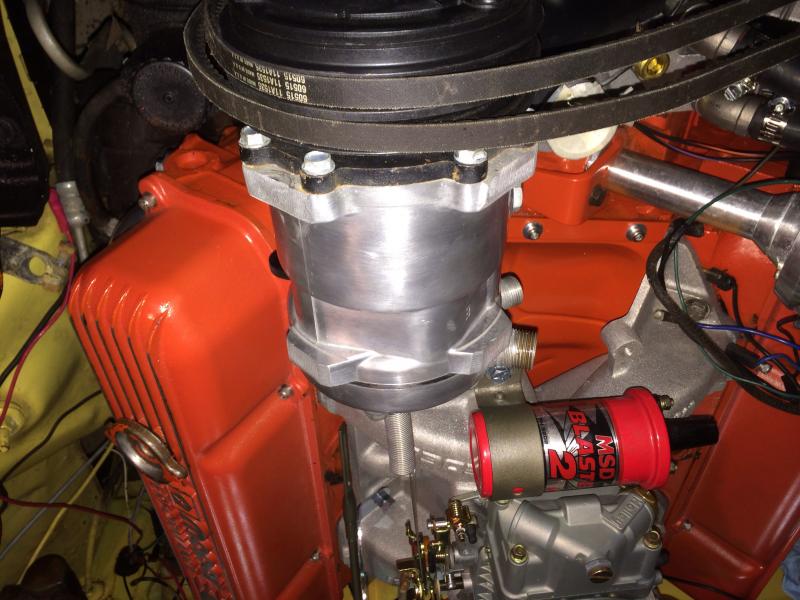

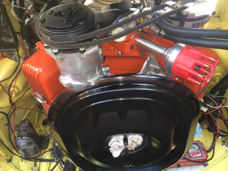

image.jpgI cut and welded the base. Got it where the hood would shut the it hit the A/C compressor so while I was trimming the breather I also took the hole holes off.of the compressor I used a 4 grinder and a tigger paw disc then painted my breather Realy didn't want to grind on breather but guess it came out ok
