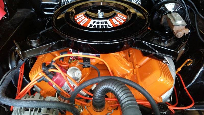

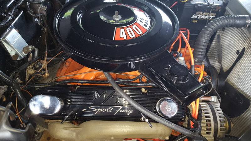

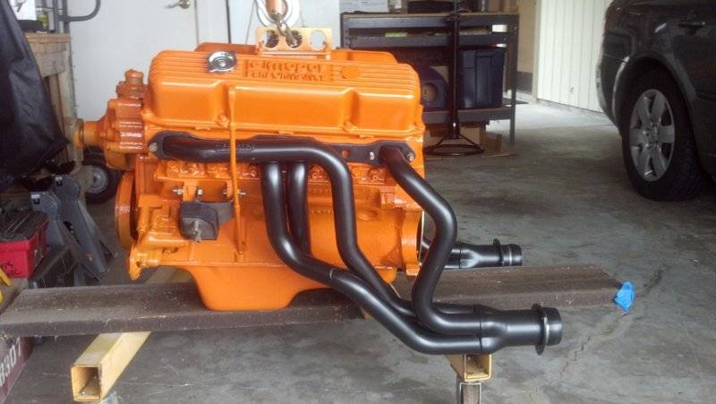

Installed them on my 64 Sport Fury, 727 cable floor shift (now a 4 speed)..had to do a little “dinging”for the mini starter.
I have a 451 (stroked 400 same physical size as the 383).
My research prior to purchase showed them one of the least problematic headers to install. I did have them ceramic coated.
Your motor is awesome looking & sure wish mine was a 4 speed! I'm putting chrome valve covers & will also need to ceramic coat these Hedmans if I get them. Might just be best to get Doug or TTI's since they're thicker & won't have to ding them. Yours & the Sport Fury sure makes me want to sell mine & find a 4 speed (like I sold a real 426 4 speed Belvedere 2 yrs ago).

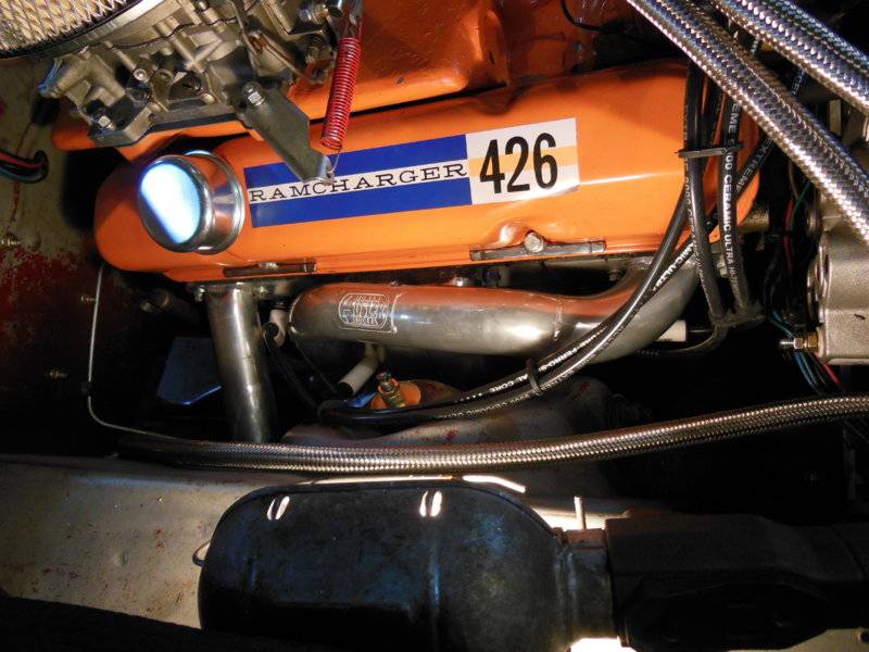

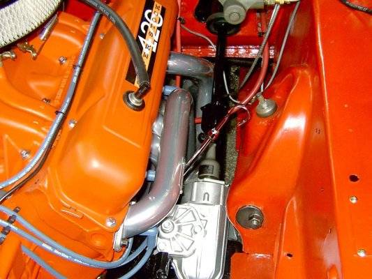

I ran the Hedmans for a few weeks in my 63. Did not like it at all. Hard to install, To much heat everywhere . Pain in the *** ! So I installed as set of BB HP mani's and all the problems went away. FYI I am running TTI duel X pipe exhaust with Eletc. cutouts. I just love the sound. All this until I install my 426 M/W in a few months !! Aloha, C
View attachment 631592 View attachment 631593 View attachment 631594 View attachment 631595
Really nice looking 440. I had a set of 69 HP manifolds, but think I'll get ceramic coated TTI or Dougs.

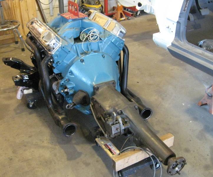

These are 1-3/4 Hedman on my old 440. Don't remember the part number but they fit fine and worked good for me. I ran them from 2006 until 2011 when I built my stroker and then I went with 2" TTI's. But I did not ding these at all and they never leaked that I can remember. They worked fine for a low buck header that I needed at the time. This is the only pic I can find of them right now. Ron

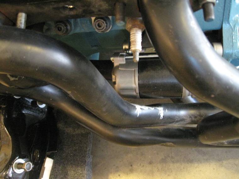

Not sure @ other guy but I used a mini starter with my hedmans . worked just fine in my 63 Ply. . but all good my friend.

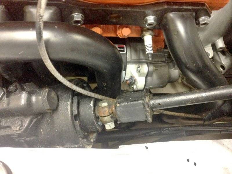

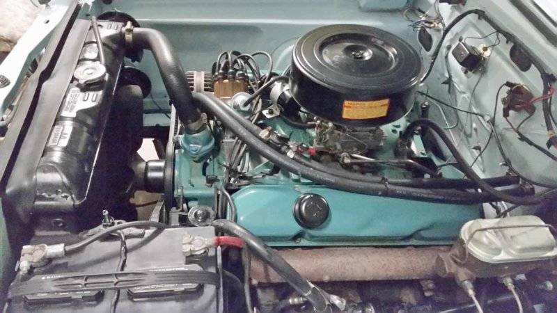

My Headmans fit the mini starter fine. Had about a half inch clearance out of the box. I wanted a little more so I dinged the pipe a little in that area. Wound up with almost an inch clearance. No problem.
They will not fit mini starters. Their design is too wide. Use a stock starter and put it in with the header loose and you'll be off and running
Believe me, the mini starter I have would not fit with these Hedman headers. A stock (short) starter went right in. Anyone want to buy a new mini starter?
