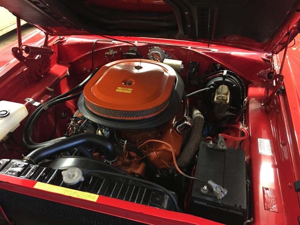

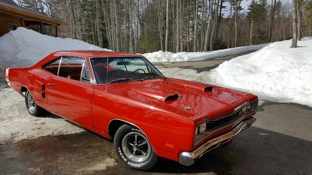

Question for 69 Hemi
My 69 bee has n96 and m46 but fender tag only shows m46. I have no build sheet. Was the n96 added after factory or is it possible it came that way but didn't show on fender tag? Someone told me fender tag does not always show all the options. Your thoughts
