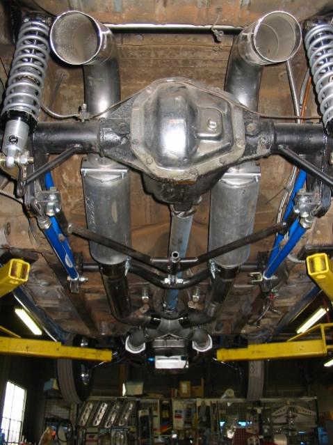

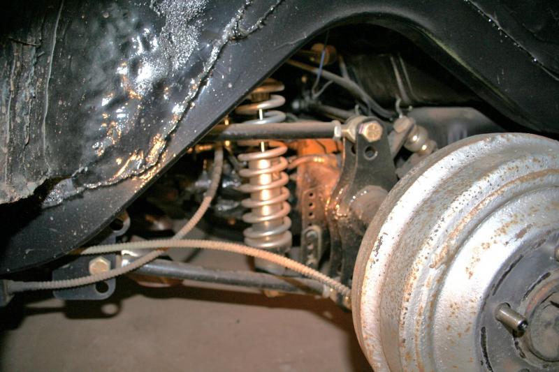

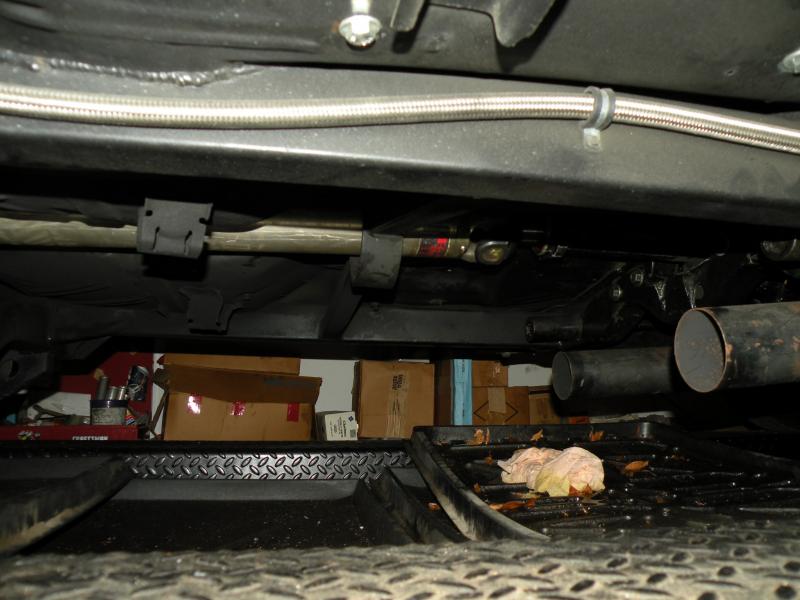

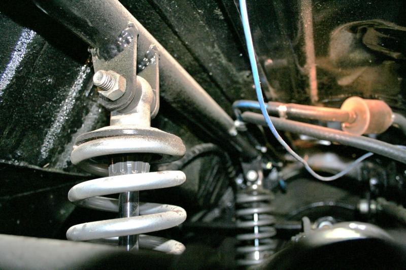

Lol, budnicks, i love it as loud as possible too... outside the car. even my buddy's straight pipe soft tail is really only loud "behind him". My car reflects back up and in. I just need a way to get the sound out the back and i might even keep the flowbastards.

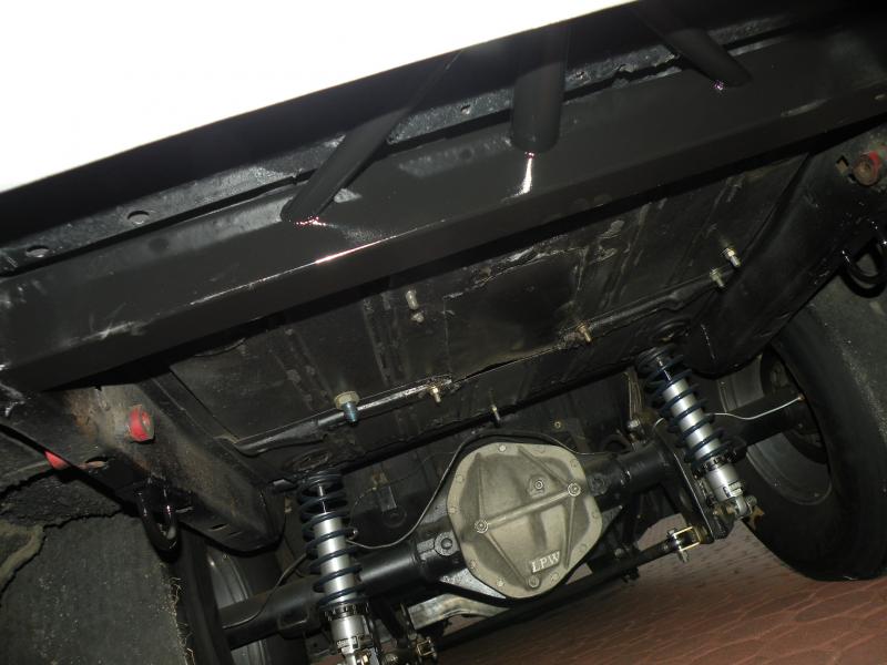

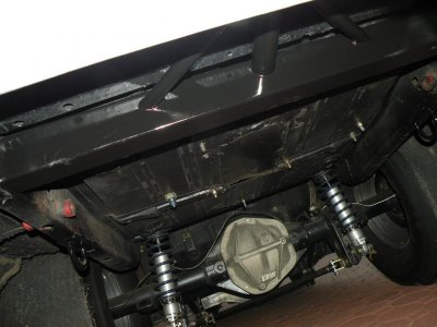

Here are some pics i took a while ago...
You guys gave me a lot to think about. Maybe i can get some 2.5" pipes between the coil overs and over the track bar and out the back.

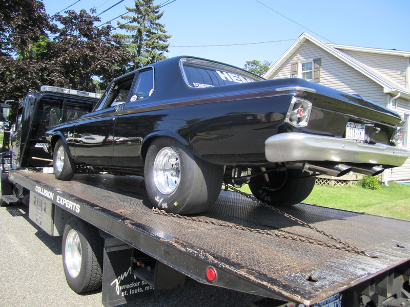

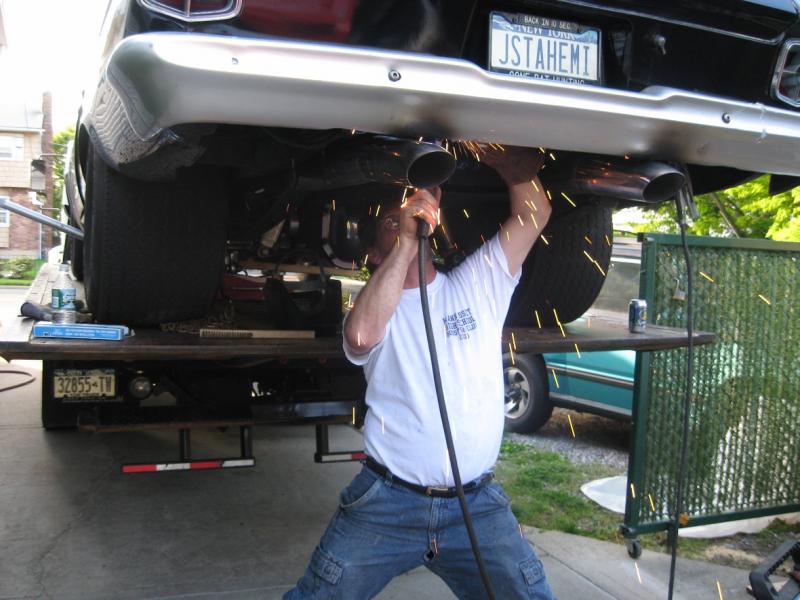

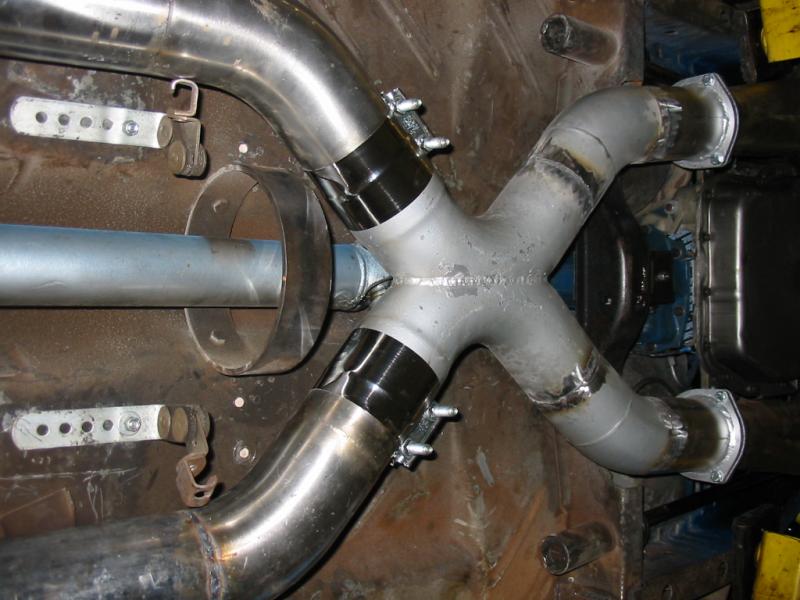

About 10 years ago,I installed a new 4 inch stainless exhaust with an "X" pipe and tail pipes out the back bumper.Since then,there is no longer the exhaust smell inside my and I can carry on a conversation while driving 60 MPH down the long Island Expressway,untill I hit the loud pedal.

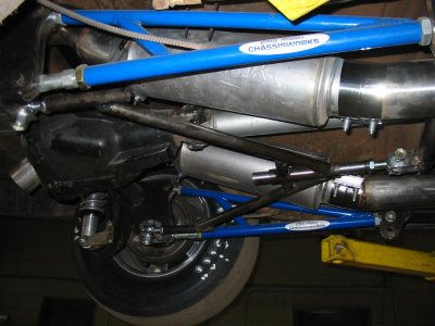

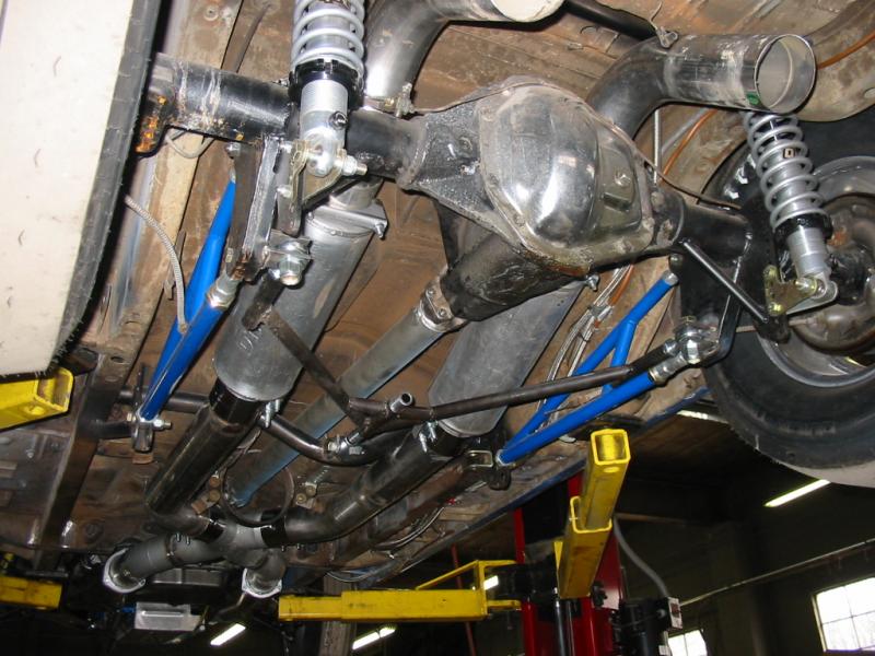

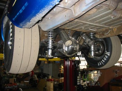

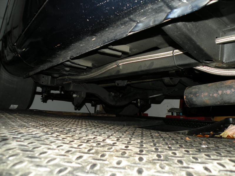

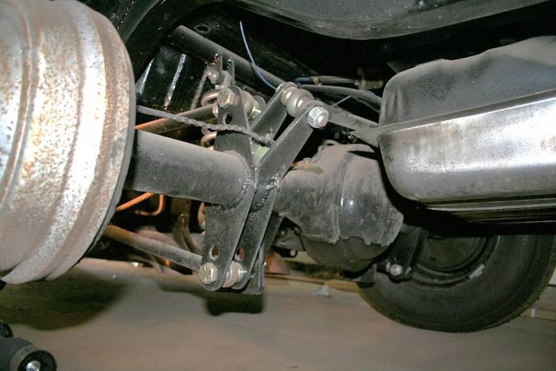

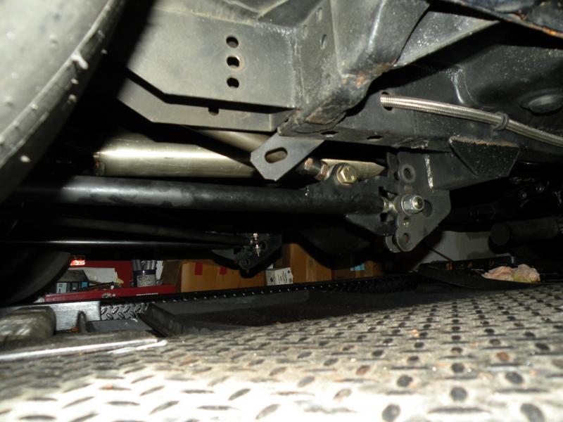

with a 4 link or ladder bar car, i cant see getting a exhaust past the front crossmember. i have a ladderbar car and when i had caltracs it was no problem running a exhaust system. now it seems that the only way to run an exhaust system is to have it end before the crossmember.
Any other pictures of cars that dont run a 4 link or ladder bar is futile at best.

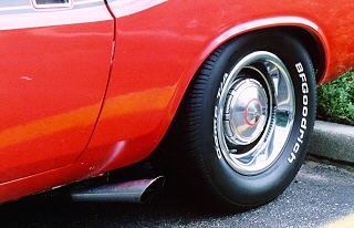

Since you already ordered your mufflers I'm a little late but what the hell. I've always turned mine out in front of the rears, I personally like them that way and if you have an X or H pipe you hear all 8 cyl. My last car and truck both had them and they sounded great especially when you where passing someone. With my Charger there are new challenges, frame rails, subframe connectors, and a lack of anywhere to put the mufflers other than right where the bend needs to be. I am planning on making a set of stainless chamber mufflers that will turn the exhaust out the side and then make a set of special tips to keep everything up tight. I did the math and plan to make the tips 1"X10" to get under the frame and then open up to 1 1/2"X10" for a little better look. Good luck and I'm sure it will sound great whatever you do.
