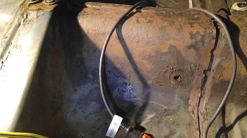

The drive shaft is four 7/16" or 3/8" bolts. Why not drop it and remove the dampener? Aside from that if you are considering what you just said, why not only cut out the small bad area and section in the new piece? The pics may be deceiving but it looks like the majority is fine. It's a toss up as to whether removing the whole thing and spot welding the whole pan in is more work than butt welding in a patch area. Myself, I would do the whole pan if I had it. I just did complete front to back pans in my Challenger and it wasn't bad at all.
