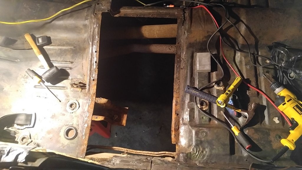

Help! Floor panel replacement

Finaly got the son of a bitch out of there.:thumbsup:
I think the welder at the factory was getting paid by the spot weld... That was much harder than I expected. Some collateral damage, but not terrible. Thanks to everyone who helped me.:thankyou:
