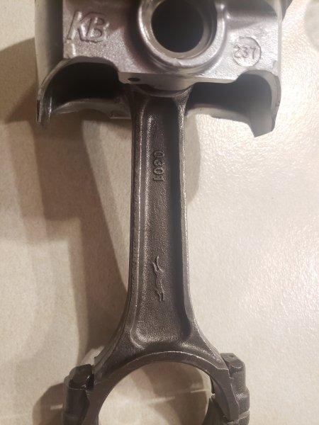

Need help IDing these rods out of my 440, tearing down my motor home 440 out of my GTX due to poor engine build resulting in rod bearing failure, trying to do do this as well as I can for my first build. Thanks!
Never seen one of those.. what is that, a cheetah? Greyhound,, kangaroo lol....
I'd consider getting some LY's
Need help IDing these rods out of my 440, tearing down my motor home 440 out of my GTX due to poor engine build resulting in rod bearing failure, trying to do do this as well as I can for my first build. Thanks! View attachment 1938973
Looks like all aftermarket
KB pistons

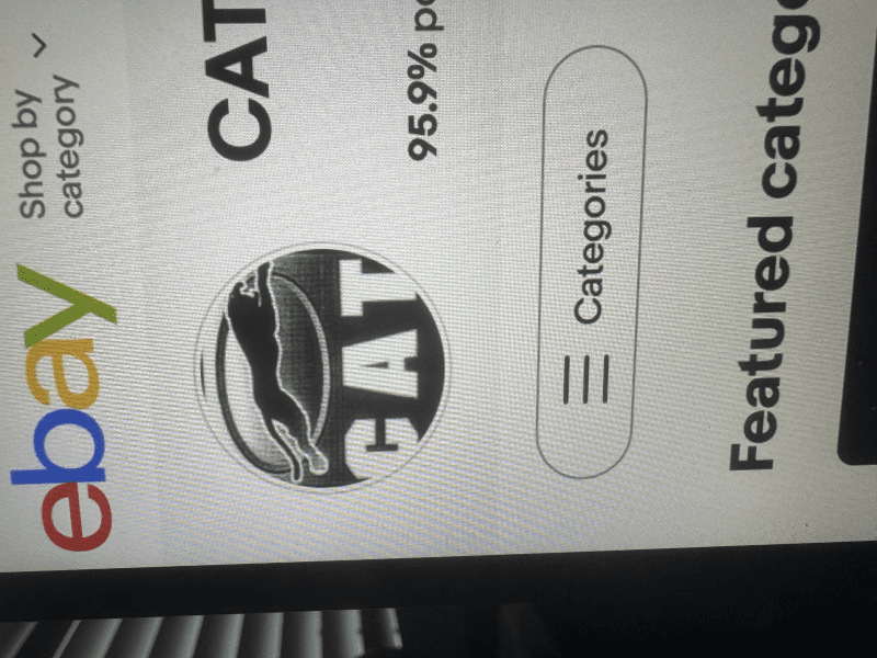

CAT rods
Decent parts IMO
Depends how it was assembled & treated !
Hopefully you can save them …..

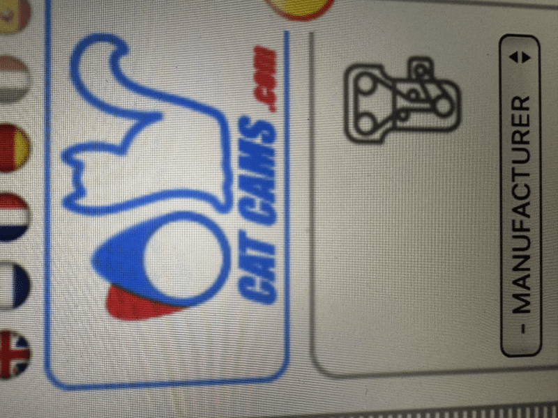

Scat's logo looks nothing like the logo on those rods....
Cat's logo doesn't either...
I have no idea who's logo that is, they don't look very beefy or particularly well finished... I would probably trust a set of LY's over those particularly if a rod bearing has already spun in one of them... What size are the rod bolts?

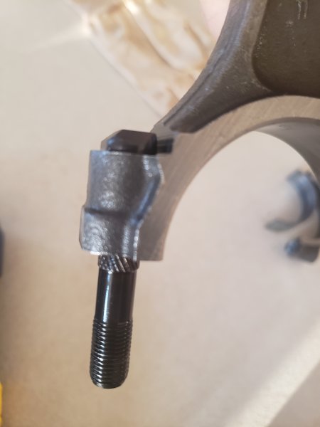

Rods have 3/8 studs marked A1
I don't like the lack of beefiness on the big end. Good thing you are going through it I think, cheaper than fixing a failure.
Not a fan of those knurled rod bolts either. The knurling has to locate the cap. Maybe that's why it had a failure
