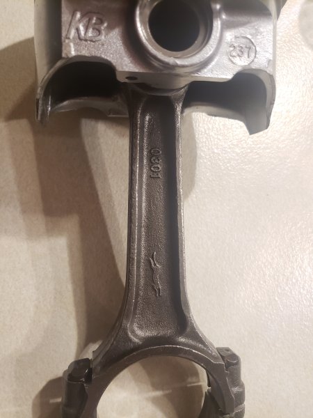

Need help IDing these rods out of my 440, tearing down my motor home 440 out of my GTX due to poor engine build resulting in rod bearing failure, trying to do do this as well as I can for my first build. Thanks!
Never seen one of those.. what is that, a cheetah? Greyhound,, kangaroo lol....
I'd consider getting some LY's
Need help IDing these rods out of my 440, tearing down my motor home 440 out of my GTX due to poor engine build resulting in rod bearing failure, trying to do do this as well as I can for my first build. Thanks! View attachment 1938973
Looks like all aftermarket
KB pistons
CAT rods
Decent parts IMO
Depends how it was assembled & treated !
Hopefully you can save them …..
