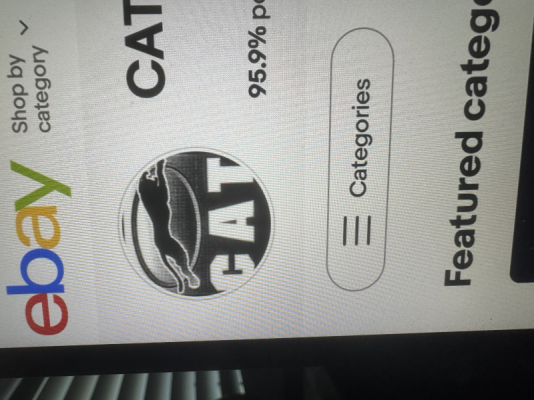

Not CAT, (caterpillar) maybe C.A.T. (chinese, ebay specials?)

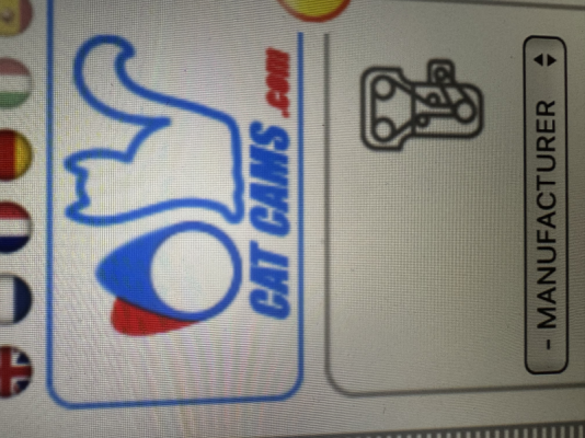

When you mentioned it earlier I knew you weren't referring to Caterpillar. But there is a company called Cat Cams that sells connecting rods... Their logo looks like this... no idea why it's posting sideways..
But since you posted I took another look and there is a second Chinese company that just goes by Cat... Looks like a win...
