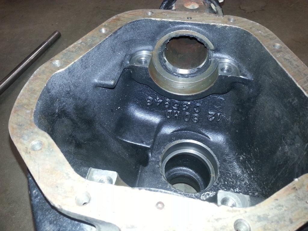

I bought this dana from a mud bogger and it did look different than the 1s I have seen it has HD inside the case and extra ribbing on it one person told me that its a Super dana 60 ?? .
Here's some pix
Since you have it apart, it's easy to check a few things. The Mopar musclecar danas had a 9.75" ring gear, and I believe a 23 spline count. The Super 60 used a 10" gear and 35 splines. - heavy duty diesel truck stuff.
I got it with 35 spline Strange axles and thru was a spool in it
