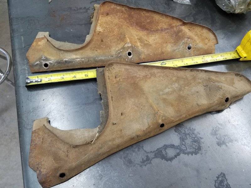

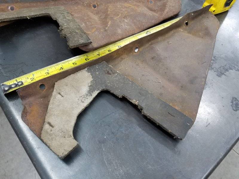

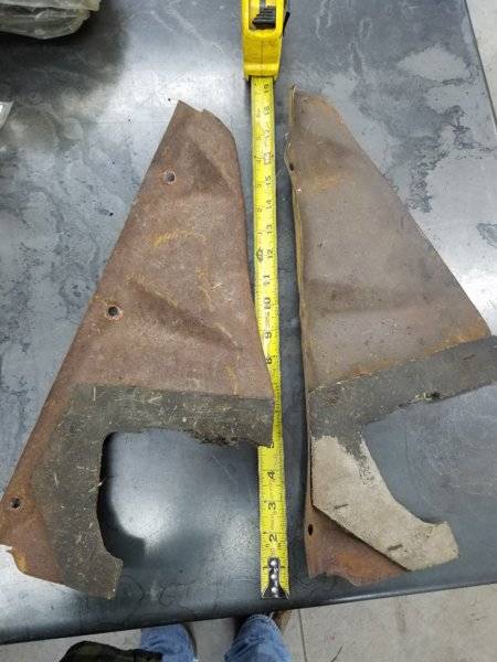

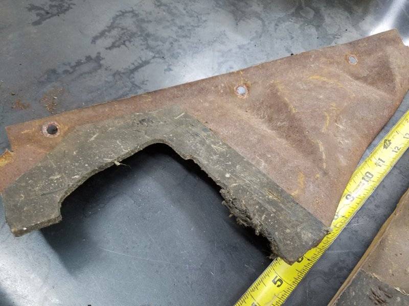

Anybody know what these shields are? Got them in a box with some other B body stuff, but I don't know that they came off one.
20190823_110315.jpg 20190823_110233.jpg 20190823_110246.jpg 20190823_110250.jpg
Above the left tie rod and center link. Attaches to the frame on Automatic cars. Shields tire splash from the transmission linkage.
Only for automatic cars........starter/trans linkage splash protector. One per car
Thanks guys. Haven't owned an automatic car for a longggggg time. No wonder I didnt recognize them.
1966 and 1967 B-bodies never used these. I know the vendors say they used them, but they are trying to sell parts, not make your car correct.
Look on the bottom of the frame rail, there are no holes.
