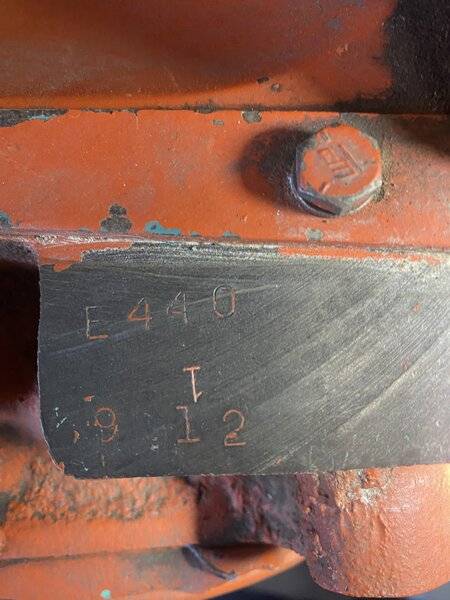

Purchased a 440 need help decoding serial members here’s what I got. Thanks
It is out of a Chrysler 9 passenger station wagon. Most likely a Newport. Built in Jefferson, Michigan.
Standard 440.
1969 Chrysler 9 passenger Station Wagon
69 440 built 9/12/1968
Block cast 8/1/68

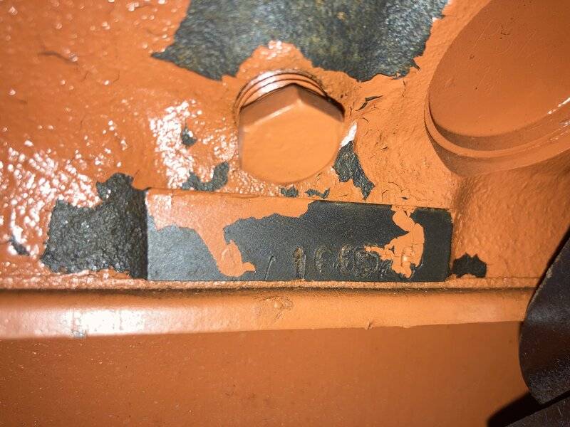

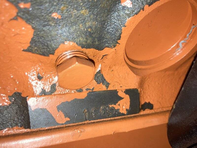

Since we’re on the topic of block codes, I though I might share the debacle that is the VIN pad on my ‘79 model year 360. What do you guys think?
