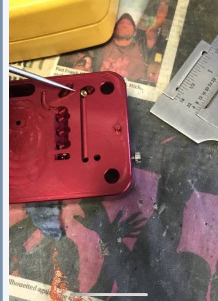

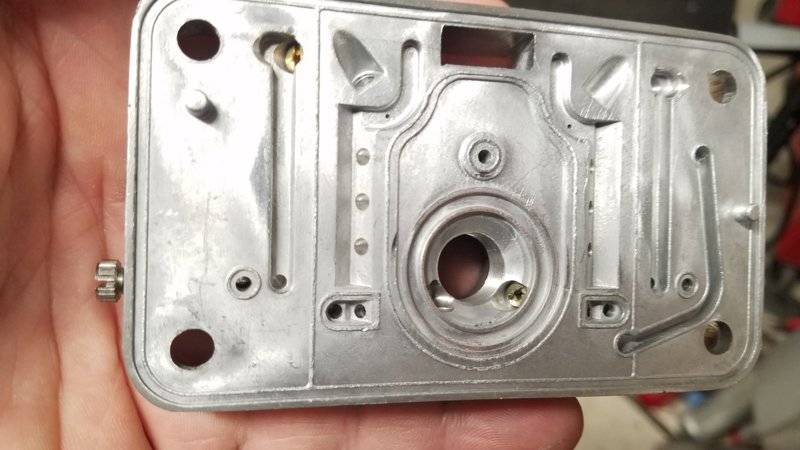

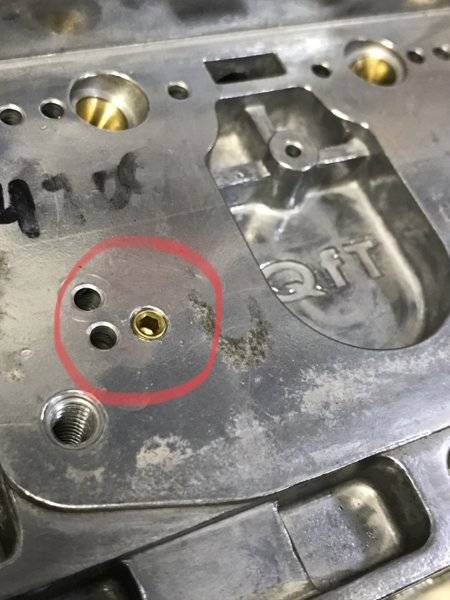

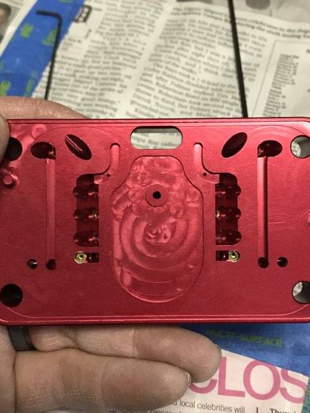

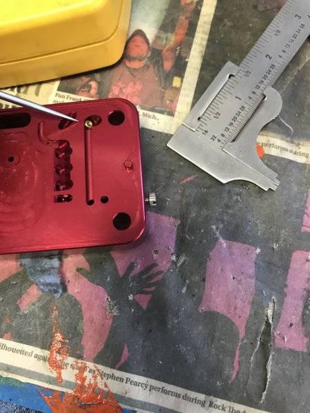

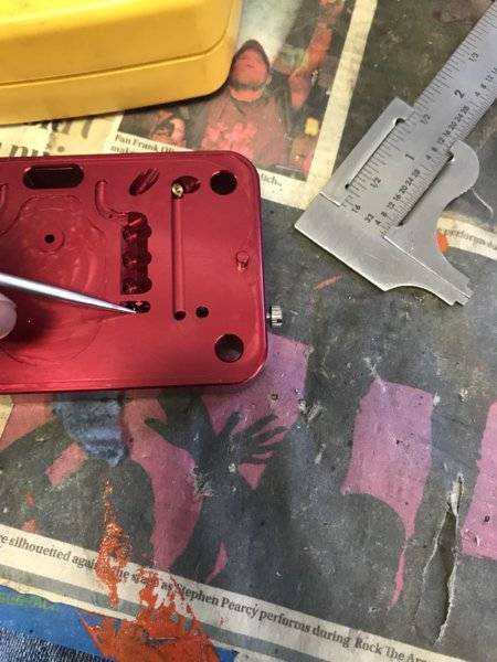

I see. Then I just drill a hole in the set screw to match the size opening I want?https://rover.ebay.com/rover/0/0/0?mpre=https://www.ebay.com/ulk/itm/112101582582
You prob don’t need a bag of 100 but that’s the size.
Tap and insert like this. Start with .078 and work your way down as needed
Use 6-32 for the idle feeds. Tap and Put them in the low spot.
View attachment 831541 View attachment 831542 View attachment 831543
