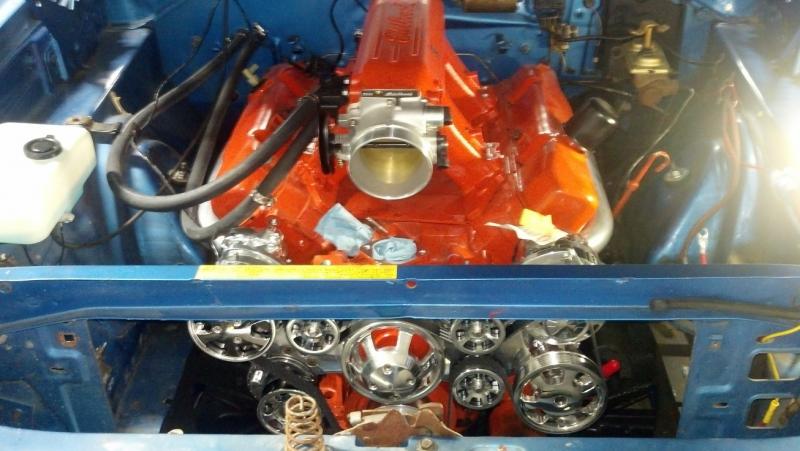

This is a pic of my engine when I was putting the XT EFI and Tru-Track on.
