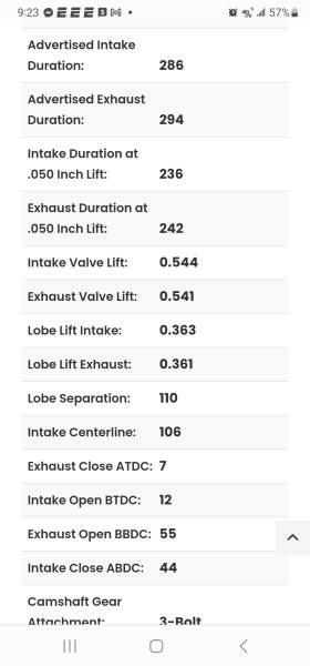

My current cam is this - but feel its a bit small for the cylinder heads and increased compression
Cam specs

That's the current cam that's in it now by comp. It's gonna be way too small for these heads and increased compression.

Current cam is hydraulic roller - specs above. Will be a bit to small with the increase in CR and new heads.
