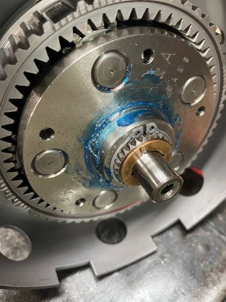

I am desperate for a 727 snap ring that goes on the 727 output shaft behind the thrust washer (see pic).
Background - I am in Connecticut visiting my Mom and brought my 727 to finally get fixed. We found the problem but the snap ring is hurt. I ordered 2 on Monday and neither one showed up.
Any one in the CT area got one where I can pick it up tonight or tomorrow? I need to be on the road on Sunday - back to Cincinnati.
Any Napa's around? It's a snap ring, not a thrust washer or anything more specialized... Snap rings are generic... I have a few snap ring assortments that would have what you need if you were closer... Good Luck, hope you get it taken care of...
I do believe this one is special. I'm waiting to get actual dimensions from the tranny guy. I believe the thickness is special.
There's an end play spec., it's actually fairly wide as specs go... I think a standard snap ring would suffice... The standard thickness in the diameter range is .042..
I agree that a standard snap ring is 0.042". This one is around 0.055", and I think diameter is special also.
But I found one! Picked it up an hour ago.
