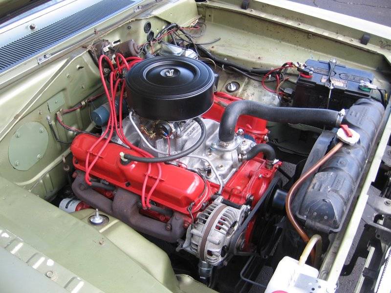

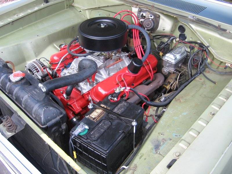

I prefer a factory style early 68-69 340 to use the breather from the valve cover to housing.But that's just me.
In the photo I used the top housing off a Slant Six and a aftermarket base and filter.
Photos are from a 68 Valiant that I had.
