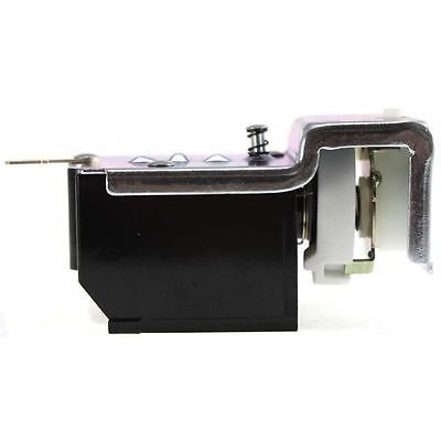

I purchased a new headlight knob. I need to take it apart to put in the new plunger and knob.

image.jpgYou should be able to reach up under dash and depress spring loaded plunger in the middle of the flat metal part of the switch and pull out on knob while it is depressed. If I remember right just push new one in or reverse above steps to install..
push button, pull out
beware though, last time I bought a headlight switch the knob wouldn't seat all the way in correctly w/ the bezel screwed into it, and it kept my parking lights on 24/7 till I robbed a factory one out of a parts car
Yup, I had to buy a NOS switch to get it to fit correctly too...
