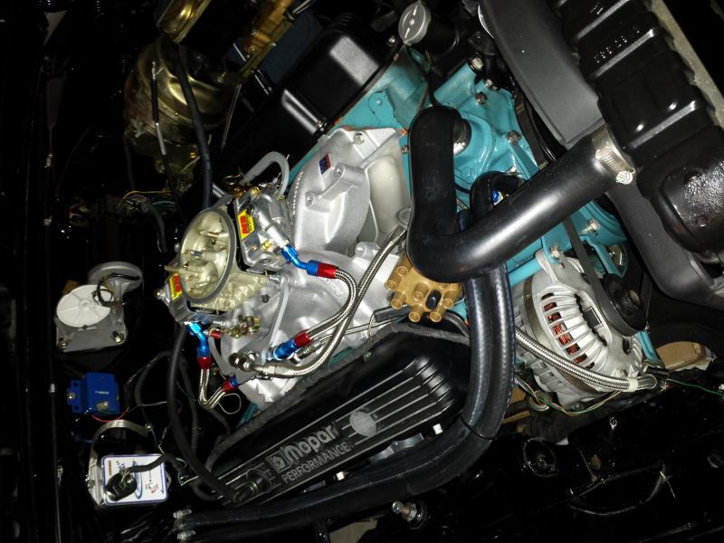

I recently put a Edelbrock RPM with a AED 750 HP-HO which came with 77/85 jets, 4.5 power valve, .031 squirters primary and secondary on my 440 with similar build but automatic. I could not be happier. Instant response with absolutely no bog. 20150320_162437.jpg
