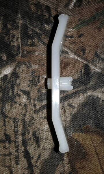

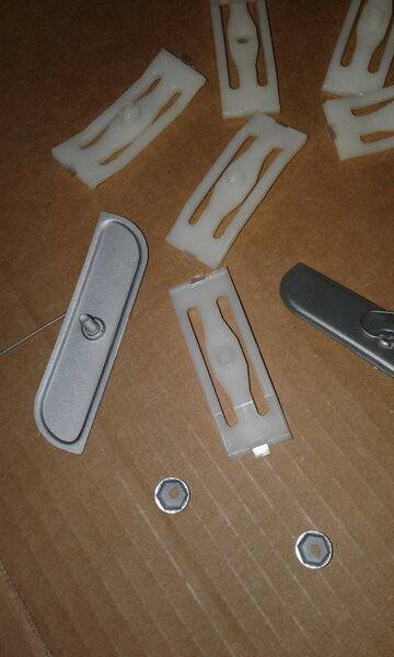

Thanks for the info! So there is a "top" and a "bottom" to those plastic clips? They're not marked and they look exactly the same at both ends. Of course, I'm looking at the repops, and maybe they're made wrong ...wouldn't that be a shocker.

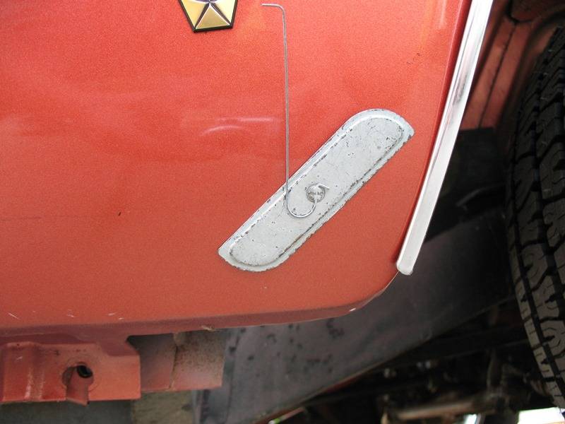

Also, do the metal clips orient this way?...
The plastic, one end should be a hair thicker with a under cut / relief, that is the bottom. The top should be a little more flexible to snap the top edge over.
The metal clips mount to the molding and will sit in it at a aprox 30 degree angle, the spring wire is pulled up or down depending on the clip and set into the molding edge to retain it. You can still move it left and right a little if needed.
In the pic you show, the wire would be pulled down and snap into the upper molding edge.
That is pretty close to the angle you will have as it sets in the molding.
Well here's what I'm looking at... pretty much the same on either side.
That little tab sticking out on plastic piece in fore ground helps protect the paint. MO you should hook trim on opposite side of tab and snap on the trim on side with tab.

Well here's what I'm looking at... pretty much the same on either side.View attachment 1055785
I see that. huh, well they should work Ethier way looks like.
