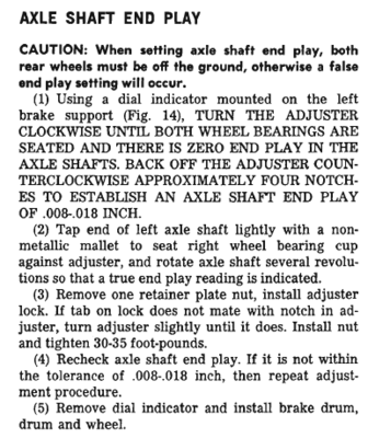

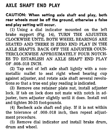

Definitely in the manual and for my 8 3/4 it says 0.008 to 0.018. This is my 8 3/4, but Dana same deal for set up. Get the spec for play on the Dana and make sure you tap the axles back and forth from each side as you set it up.
The manual I downloaded also says .008-.018 for 8 3/4. No Dana info.
But a tapered bearing is a tapered bearing, I hope??? so I'm going to shoot for the same numbers.

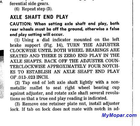

Don't like posting info that's bogus, this is out mymopar 66 service manual, I wouldn't run Over the .018 in other posts. Set mine .013. This isn't to get into a pissing contest.
Chrysler tightened up the end play sometime after 1967, to .008 to .018. I would lean towards the low end of this.

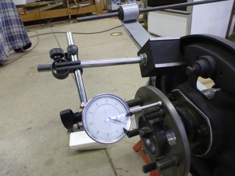

Ok, so the adjuster is supposed to be on the right side but you use the dial indicator on the left side, to check for end play? correct?
