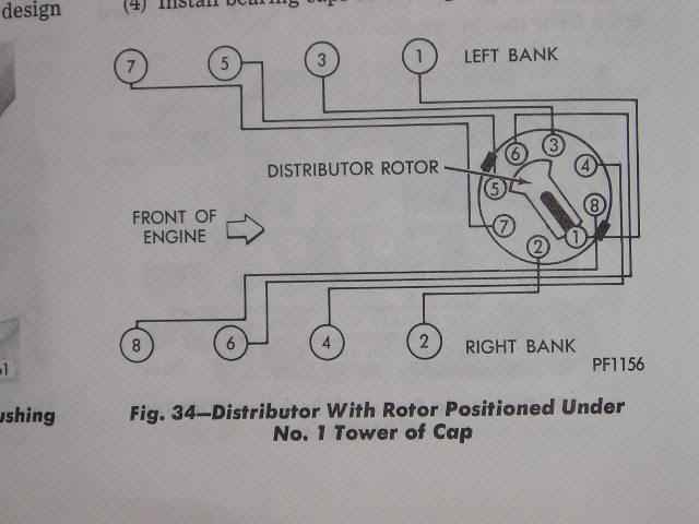

I'd pull all the plugs, rotate the crank with a 1/2" ratchet, with your finger in the #1 plug hole. When you feel the compression building, watch for your mark on the crank. When it lines up with top dead center, stop. Then check your distributor for alignment. Remember the firing order is counter clockwise. Your rotor button should be just starting to line up with the #1 tower in the cap. Not dead center. CCW direction, 1-8-4-3-6-5-7-2
