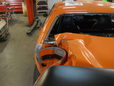

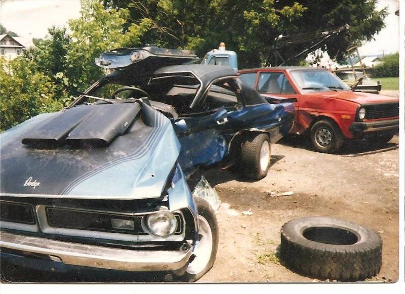

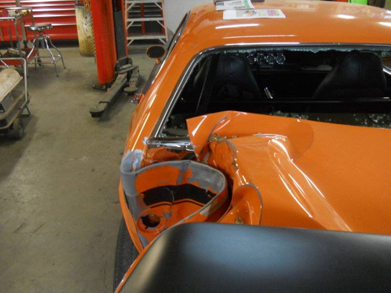

Ask me how I know. I left the front end shop tighten my chinese eccentric bolts. Out the door it went an here is what happened to my car. Took a while but eventually one failed. It was stripped as were two others
Or how about this . The boy died in this car because of one shotty repair by a wanna be mechanic he took it to . The parts always seem to fail at high speeds. not at stop signs. Now look at these pictures and think about what you did after some of the good advice that was given at the beginning of your post. Why did you even ask?
