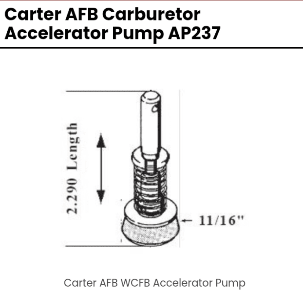

Went through this scenario with my 4429 avs. Most aftermarket kits supply a 3/4 pump. Mike's specifically lists the 11/16 for mine. The 3/4 would not allow a full stroke but the smaller one did.
They appear to be selling the same kit I ordered based on the picture and shooter sizes. I’ve read buyers are a little unhappy lately when they receive it because the two larger ones no longer have brass tubes and are just drilled aluminum now. But I guess they will last far longer on the car than I will.
