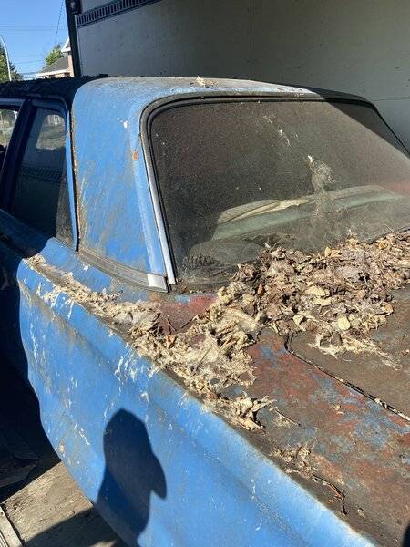

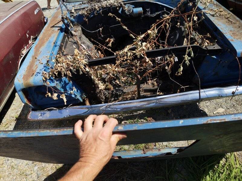

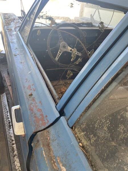

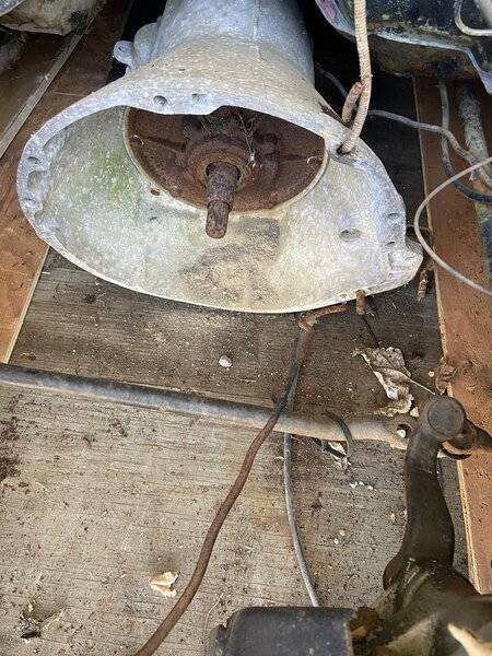

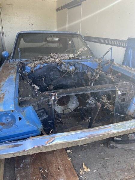

Friend of mine picked up this car today for real cheap. It was sitting in the prickle bushes for years. Shell is pretty good. Missing motor, rear end. Any idea how many were made?? Can you tell if this tranny is a Hemi tranny by the input shaft.

Need the numbers off the drivers side pan rail of trans.
Does it have a fender tag? There is a rear seat in there look for a broadcast sheet.

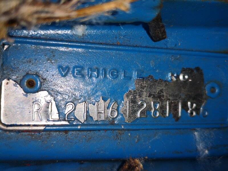

Looks like the 5th spot in the vin is a (h) which indicated 426 for the 66 model year.

Looks a tad bit rough
but for a $1k
you can't ask for too much

Pk # on trans will tell the story.
Looks like Hemi K frame is gone.
My money the hemi trans is as well.
But....maybe he gets lucky amd its in there.
