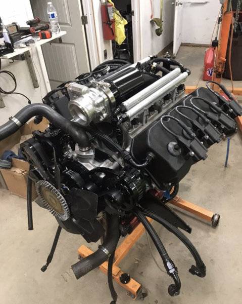

Mine were polished at one time. I used Duplicolors engine enamel wrinkle paint and placed them under heat lamps and used a heat gun.
