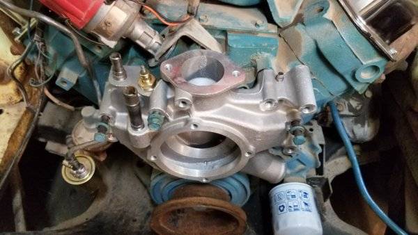

I can use the 1/2" outlet that's plugged off to the right of the hole in the pic by using a bushing for the temp sensor - but then, what do I do about the heater hose adapter?
Did later model 440's actually use an adapter that necked down to 1/4" NPT?
I am in the middle of the install right now and thought a picture with nothing else in the way might help. The tall heater hose fitting is farther forward than the one next to the bushed temp sensor . Oem versions of the short one had a strainer in case a chunk of casting flash got loose I guess.
First I've heard of that. Got any pictures of said strainer?
