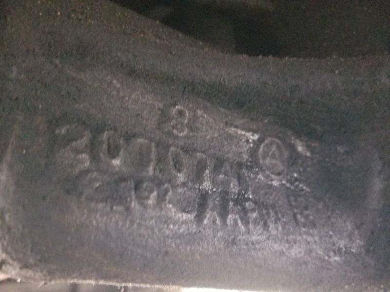

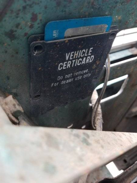

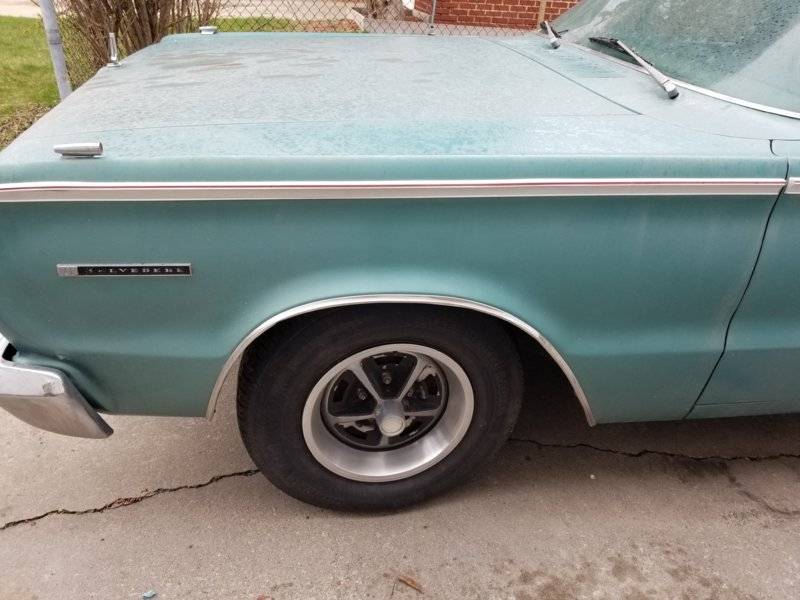

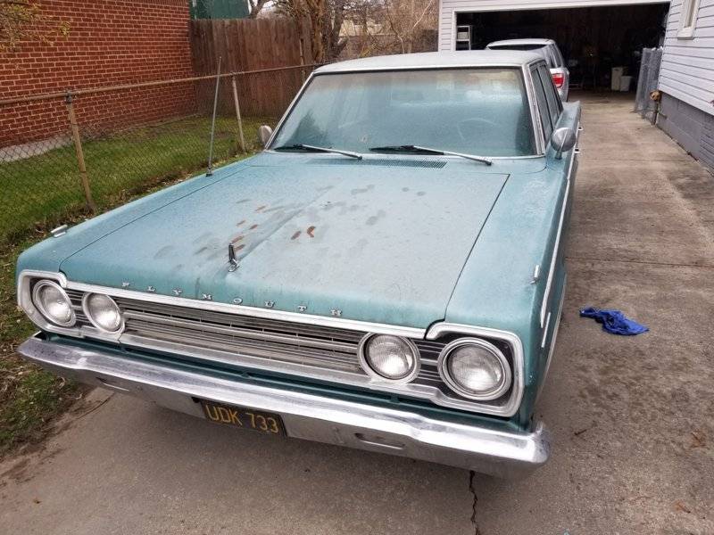

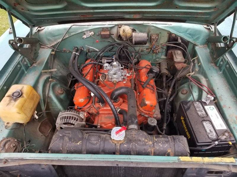

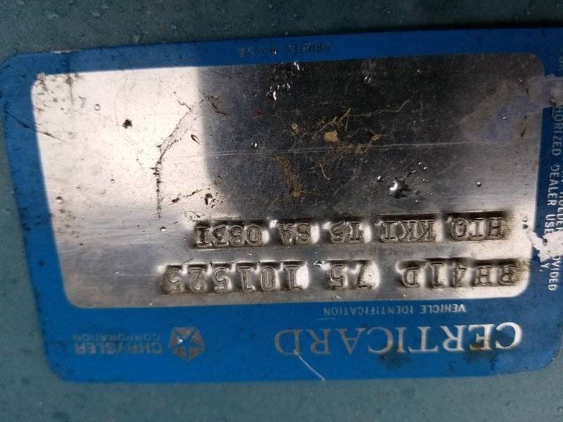

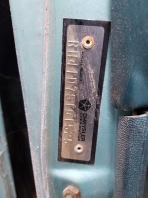

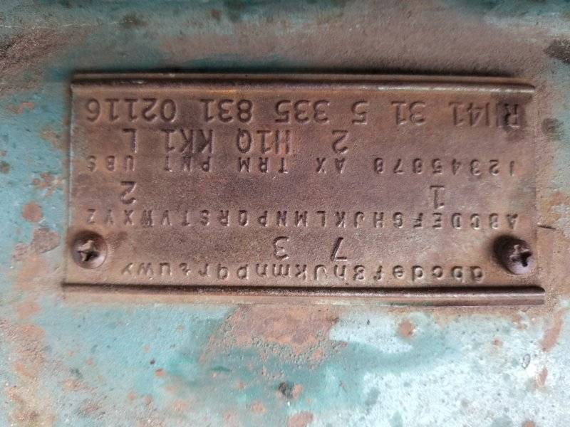

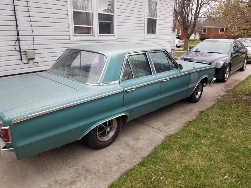

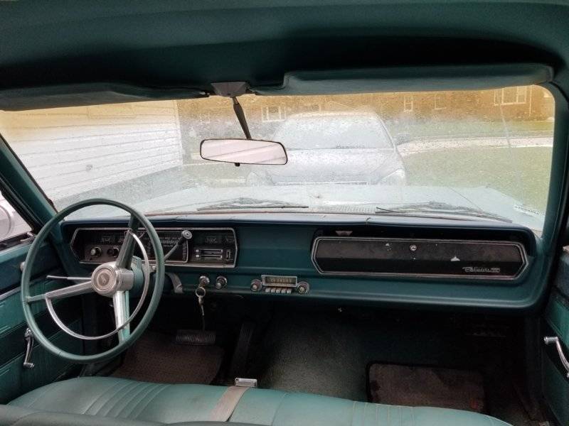

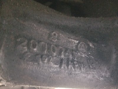

Ok, so the car finally showed up. Here's a picture of the rear end serial number...and a couple more. I have low standards, but I'm pretty happy. My son is amazed...it was worth 10 times the price to see him get excited about building this car.
Anyone that can tell me any of the history of this vehicle, I'd appreciate it. I have no idea what all the identification numbers mean....
20200330_164804.jpg 20200330_162843.jpg 20200330_162853.jpg 20200330_165432.jpg 20200330_165439.jpg 20200330_165053.jpg 20200330_162726.jpg 20200330_162713.jpg 20200330_165529.jpg 20200330_165601.jpg
That looks like a 741 case 8 3/4 which is date correct.
My guess is a 2.94 gear.

The best resource for 66/67 fender tag decoding while not complete is the 66/67 Charger site.
I don't have the link handy, but it's been posted here several times.
RH41 Belvedere 4 door sedan Premium upholstery
31- 273 2 barrel V8
5- auto
335- should be 5 -7.00x14 black 4-4 steel belted police tires
831- August 31 built
Shipping order number
Line 2.
A/2- 2.76 ratio axle(great economy)
TRM/H1Q-high quality, cloth vinyl bench,
turquoise
PNT/KK1-medium turquoise metallic
UBS/L- Dark uppercut door frame paint
Row 5
E/1- cleaner air package
X/2-tinted glass windshield only
6&7 row
-h/7-fender mounted turn signals
-m/3-mouldings -deck lid release knob
I don’t see a code for the radio. Also the 741 on the center section is a small pinion.
