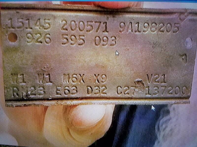

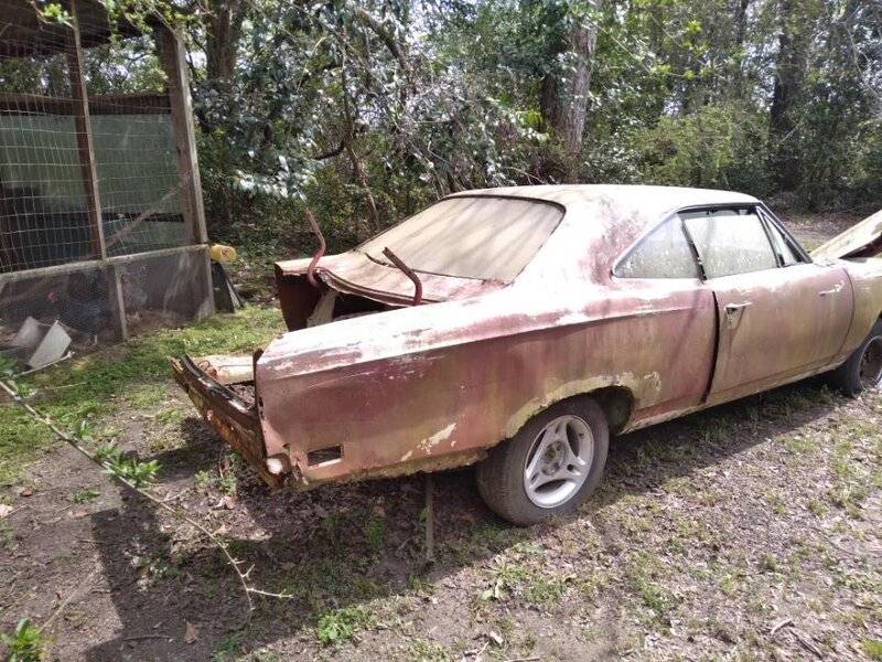

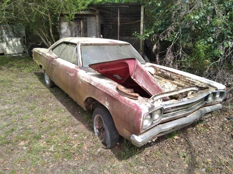

Here is my 69 roadrunner project. Throw a catalog at it cause it needs everything in the book lol. It has a fender tag and radiator core support numbers but the dash and vin tag are long gone along with all the interior. I've been trying to decode the fender tag and radiator core support numbers to try and figure out what the vin tag would have read but I'm not getting very far with it. any incite guidance or help of any kind on this would be greatly appreciated. lol got a long rough road ahead but I'm so glad to have a B body to work with. Thanks in advance.

Thanks Will do.first I have to get this dash vin tag squared away lol. Looking kinda complicated so far.

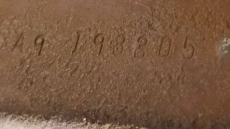

Here are the radiator support numbers for my roadrunner. I think these numbers are somewhere on the fender tag also.
looks like the guy punching the fender tag was dyslexic, hope you get it all sorted out , nice project , good luck to ya
Looks like its a Lynch Road build. Radiator stamp matches year/plant/Vin sequence on upper right of fender tag. So you know its a RM23, and Year/plant/sequence number. Tag also tells you engine, so you should have that missing digit, wala, there's your VIN.
Cool thanks. Ok, So from what I can tell there are 13 digits in a dash vin number,is that right?and it starts out with these four RM23 correct?
Thanks , yea man,I noticed that it was backwards to. wow I don't know what to do about that. I'm still trying to figure out what the dash vin tag digits are but reading the radiator support numbers and the fendertag
