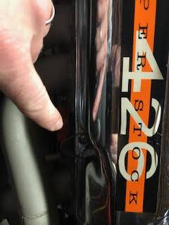

While cleaning bolts and brackets for paint and re-assembly, I had an idea. Not long ago, I made a small clip out of a wire coat hanger. I attached the clip to the lower rear bolt on the drivers-side valve cover to route the spark plug wires away from the headers. The clip holds the wires (5 and 7) together until they're above the header, then they split into separate directions.
I've heard about interference issues on the 5/7 spark. I know folks have run cams designed with a different firing order to eliminate this interference. I'm wondering if this clip may have caused more problems than it helped. As I think back, the miss started right around the time this clip was installed. I won't get to the track until spring.
Do you think this clip may have caused the problems described? I am not changing the combo as it's worked very well for years. There's obviously a gremlin in hiding! Thanks in advance.
Maybe, that one might be solved by a little experimentation.

You can certainly experiment with greater insulation in the areas of concern.
Wrap the wires in a piece of inner tube and see if the problem persists.
You could modify your hanger with some dip-it to insulate it better.
Even if it's a little ugly for testing, just so you can find / rule things out.

Seems to me if the miss reared it,s head after
you installed the clip that is possible your problem.
I'd reroute those two wires so they don't run
next to each other &see what happens.
