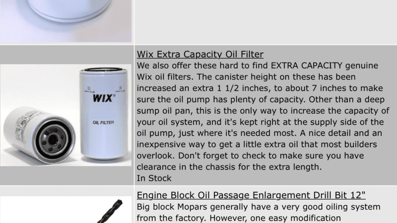

also has anyone used the extra capacity wix oil filter that 440 source sells?
I've had my high volume high pressure melling oil pump with windage tray on a 440 for 30 years. Oil pressure is 70 lbs hot, but I also run a 7 quart pan. As far as the wix filter. I use the 51515 filter.
You can run a high volume pump with a 6qt pan and windage tray without a problem. 440'
Anyone use the extra capacity filter from 440 source?
http://store.440source.com/Wix-Extra-Capacity-Oil-Filter/productinfo/138-1005/

Reading the verbage of the Wix advertising......
"Other than a deep sump oil pan, this is the only way to increase the capacity of your oil system, and it's kept right at the supply side of the oil pump, just where it's needed most".
The wording is incorrect......the filter is on the discharge or oil pump outlet. The wording indicates is the filter is on the inlet of the pump. The larger filter (more internal surface area) will result LESS pressure drop or pressure loss thru the filter INCREASING the volume available to the engine for a given RPM (assuming the same oil viscosity). Boyle's Law applies...... Just my opinion of course.
BOB RENTON
