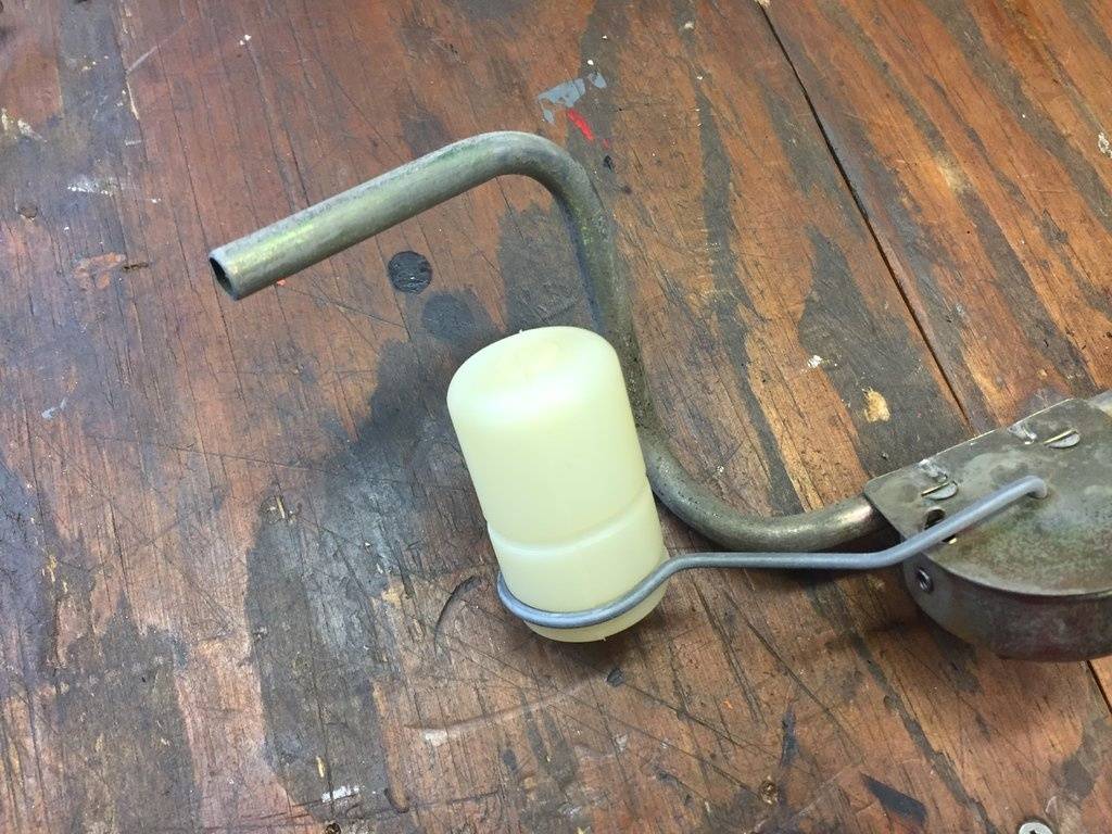

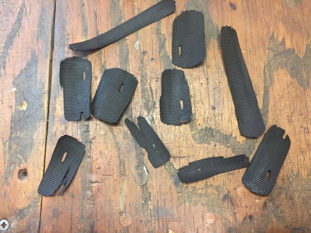

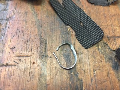

After removing the pick-up it was quite clear....no suction screen in place.
I did find a lot of pieces of black fiber, see picture.
There were heaps of small pieces lying about so i put a gallon of fuel in there and washed them all in 1 corner and sucked them up with a vacuum pump.
Tank is clean and new pick-up installed.

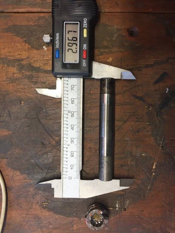

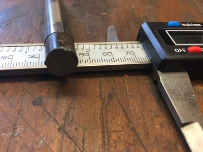

Up until the last year I had never heard anyone talk about worn out pump rods. Mine has 86k on it and still works fine(?). I didn't even know there was a measurement..
Yeah, original length should be 3.220", as seen mine "lost" 0.233" which causes a very short pump stroke (if any) on the fuel pump.
Apparently the original ones are the ones to keep.
As some others said, they are the ones properly heat treated to be hard enough to survive.
Most aftermarket push rods are not designed for survival, the manufacturers rather have it to run to destruction and take the camshaft with it so you can buy another set of them.
With that said, i think it is a good fail safe to have the push rod to wear out first rather dan eating your camshaft straight away.
When on aftermarket equipment just change them every so many miles/years and keep a good eye on the camshaft.
With a price of $20 a year for just that you can't go wrong.
I got a link for a NOS push rod which i ordered and ordered another 2 Howards from Summit racing.
Time will tell, guess i will go for the Howards first, let them polish the camshaft up and take it from there.
I do/hope that the cam lobe is harder than the pump rod.......

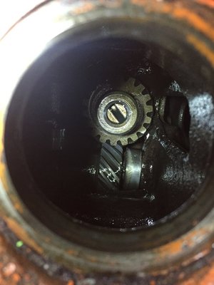

Looks like, my push rod is 0.223" shorter but the cam is still there :)

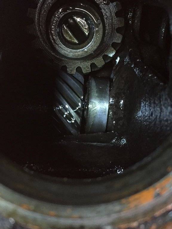

Here some pictures of the camshaft lobe for the fuel pump.
It shows some small damage on surface but no deep grooves have worn in.
Think a new rod will polish it up.
Hard to say, long distance, but 'if' the lobe is within reason, go for it. Might wear a little smoothness into it.
Had a feeling about your pickup screen...bet it was lovely...sitting at the bottom of the tank. Exactly why I didn't put one on. Seems today's gas will eat at some of the older car's parts. Of course, old age could have done it, too.
At least your getting somewhere on it. Good show!
Yeah, i left the screen on the new pick-up, but as most plastic material deteriorates over time when in contact with hydrocarbons.
It becomes brittle and will break, therefore i guess the new one will sit it out for some years to come.
